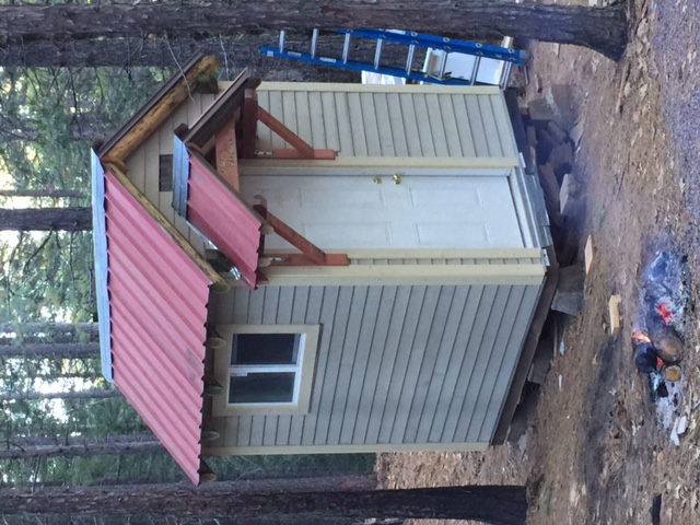

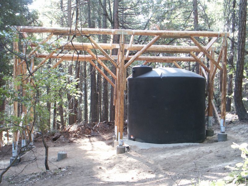

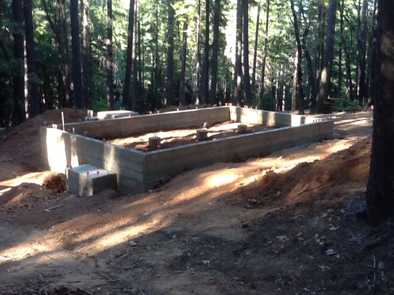

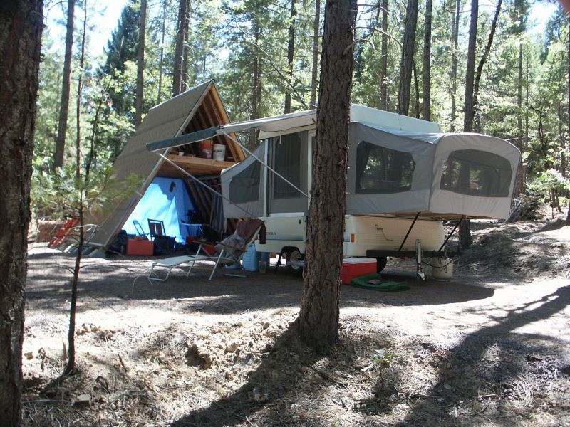

  I recently built a 6' x 7' outhouse/bathhouse on my property so I could use my septic system. I applied for a permit, assuming that the permit would only be for plumbing since the building is less than 120 sq. ft. But because I'm in seismic and snow country they wanted a permit for the building. They allowed me to build on piers (sunk 18" into the ground) but only reluctantly. VERY reluctantly. The reason was that piers just don't work in any way in any seismic calculations. The reason they let me do it is because I brow beat them over the fact that this is a 42 square foot building, for ****** sake! I don't give a ****** if the ****** thing falls over! It's an outhouse! It's not going to kill anyone! Stop applying theory where it doesn't apply!
  Now, when I poured the foundation for my 300 square foot cabin, the only rebar actually required was one #4 top and bottom, nothing else. That, to me, is stupid. I put in far more rebar. I'm going to be sleeping here, and when the quake hits I want this structure to stay on the concrete and the concrete to hold together.
  As for vacation cabins or permanent residences in non-seismic areas where the piers are not tall above the dirt, it doesn't matter. The piers are not going to collapse in the dirt, but the walls could collapse on the piers. That's how I see it.
  Sorry to hijack the thread. Don and I have a long running professional 'discussion' about use of piers, which I see as a healthy discussion about the limits of the use of strict engineering. Maybe it should be on a different thread, particularly if I continue to drink strong French Roast in the morning!     42 sq ft outhouse on deep piers
  |   300 sq ft footing with lots of rebar
  |   Post and beam shed on deep piers
  |   A frame on piers on grade

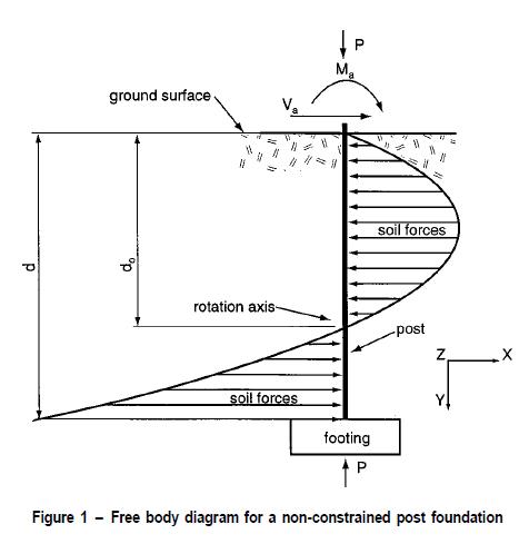

  An explanation of the engineering standard related to shallow post and pier foundations is in the link below. I have the standard as well but piers are too much theory for me, a continuous foundation is stronger and avoids guessing and misunderstood theory about what shoulda worked.  http://www.constructionmagnet.com/frame-building-news/shallow-post-and-pier-foundatio n-design-major-revision-of-standard-completed

  I agree with you Don that soils (generally) provide little or no resistance to rotation, and I'd go further and say that if a lateral force is applied over time the soil will move out of the way of the rotating object, witness leaning fences with solid posts. But in the case of a pier, rotation is limited by the fact that it is secured at its top to a floor diaphragm. It is not as free to pivot as a canted joist or fence post. Obviously the connection is critical. So, applying the principle of 'building importance', I think piers will hold up 'well enough' for 'buildings of lesser importance' or 'minimal threat to life health and safety'. Small cabins are dicey at best on piers alone in any area with any serious possibility of lateral force such as wind or seismic, so then the debate shifts to whether or not lesser requirements should apply in 'temporary use' buildings. Problem is that temporary becomes permanent.

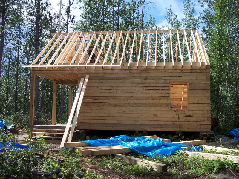

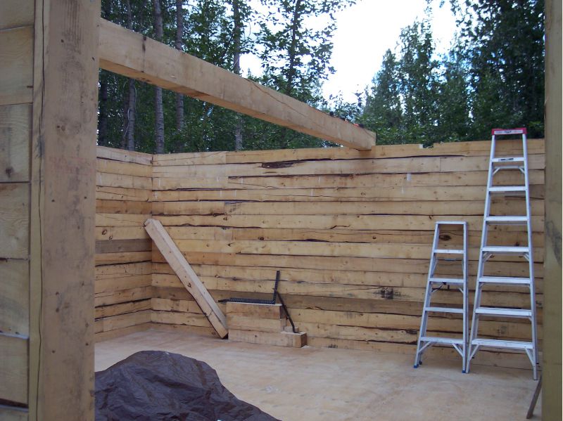

# Posted: 16 Jun 2015 11:38am

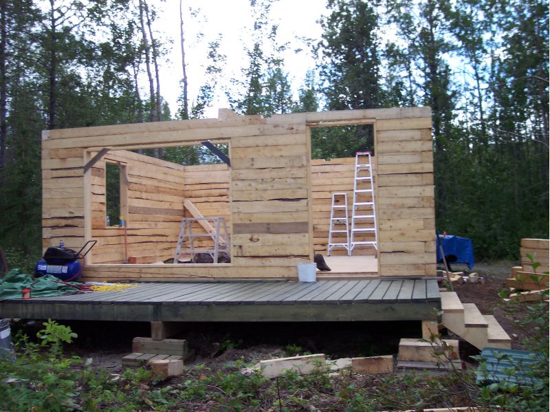

  We used stacked 6"x6" for our build. We used sill plate foam in between. I think 4"x6" would work fine, it would just take more rounds to make an 8" wall.  07_L_S_and_sled_pics.jpg

# Posted: 16 Jun 2015 03:33pm
  Nice buildings. The only problem I see with this method is that if water gets between the timbers it can't drain away. A good gasket may solve the problem, or other sealant. But this must be maintained, and if not, rot may set in. The best way to deal with moisture is to give it a slope to run away, rather than relying on a sealant to keep it out of where it cannot.
leonk
# Posted: 16 Jun 2015 09:40pm
  foam has short life span, I'd use something like jute or wool. BI, correct, however with nice overhands (like any other log bldg) very little water will get in and if it does, it will evaporate, in dry to moderate climate. I wouldn't do it in coastal Oregon.
littlesalmon4
# Posted: 18 Jun 2015 12:48pm
  First time i have ever heard of foam being accused of having a short life span. You can find that stuff lying around everywhere, never seems to break down. If it starts breaking down it would likely be caused by UV light. With this method the foam is tightly squeezed between 2 heavy beams and fastened with 12" spikes. There are no air leaks so I think water would be unlikely. We put an addition on last year and removed a 12' section. There was no sign of water between the logs. This building went up about 8 years ago.
