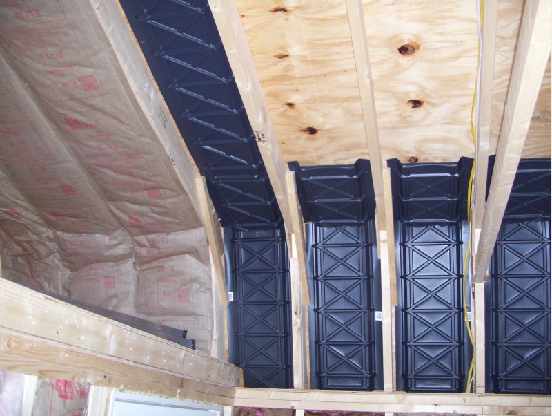

  But you are planning to use batt insulation.  That will work, but in that case you may need to vent the underside of the plywood, and that likely means drilling holes in the soffit.  The problem is what happens to the humidity created in the cabin- particularly during the winter.  Humidity comes from many sources, including cooking, bathing, use of propane and other heating sources, and some is just expelled by living bodies.  If humid-enough air comes in contact with the cold plywood it will condensate.  With the insulation batts, it will likely not evaporate well (at all?), which could lead to rotted wood, mold/mildew, bugs, or some other nasty issue.  Faced insulation will help, as would the addition of tight, vapor-impenetrable ceiling materials, but it's safer to assume some humidity will get in that space and the only way to remove it is with air flow using outside air.
  RifRaf and I are following a similar cabin plan.  Although my cabin is not used in winter (can't get in to it usually), I decided to drill holes in my soffit and install plastic rafter vents that keep the insulation from directly contacting the plywood and provide an air-gap between the two.  The holes in the soffit open into those rafter vents and allow outside air to flow between the plywood and insulation.  The other piece of this puzzle however, and your initial note does not indicate, do you have a ridge vent?  Holes in the soffit allow air to enter the rafter vents, but you also need someplace for the air to exit at the top.  A ridge vent is the typical solution for that.
  Below is picture that shows what I did (obviously this is a work-in-progress picture- the channels were ultimately completely extended from soffit to ridge, and covered by insulation).
  I hope this helps.  Rafter vents and insulation

  You MUST Vent the roof between the insulation & plywood like PA_Bound shows (those are  perfect).  You will have to provide air intakes in soffits, often the easiest is the "strip vents", 3" wide that can be pushed into the cut.
