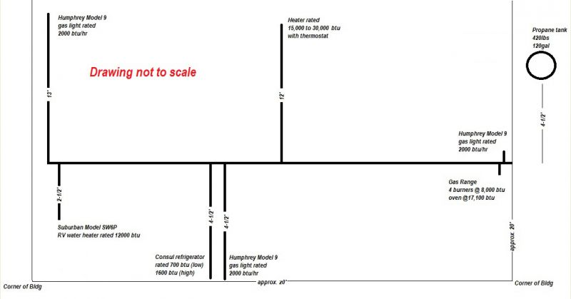

I finally made it up and completed my drawing. This is my rudimentary distribution plan, given the appliances I now have.
Looking to determine pipe sizing (trunk and branches), best layout, etc.
Right now I have the trunk running parallel with floor joists with the branches running perpendicular. This is how I took my measurements.
Your feedback is welcome. Thanks.

Hi Bobrok- I looked it over and compared to the current California propane gas pipe sizing chart. I'll spare you the details and give you the gist.
You have a total of 100k btus with all your appliances, and 40 feet of pipe (or less) to the furthest appliance. 1/2" steel pipe will handle that many btus with the furthest at 40 feet, so you don't need any 3/4" pipe.
But 1/4" copper tubing will only handle 21k btus at 40 feet. This is more than enough for your lights and the water heater and refrigerator, but not the heater or the stove. So I suggest you run a single 1/2" pipe from the source tank to the heater and stove, and use 1/4" copper for all else, branching off the 1/2".
If you use a single 1/4" copper line to supply and branch off to the two lights, refrigerator and water heater you will be at the limit of the capacity of that branch before it splits off to the separate appliances. Just to be on the safe side I'd use 1/2" all the way to the water heater and use copper branches to supply all appliances except the heater and stove. The 1/4" copper isn't large enough for them.
I bet you'll notice some difference in how the heater and maybe stove operate once you upgrade, they were pretty undersized before.
Hope this makes sense

Bobrok- my mistake- 3/8 tubing gives you a max of 44k based on 40 foot maximum run. So it looks like if your entire system AFTER the stove were made of 3/8, it would be just over what is 'code compliant'. It would probably work ok with all appliances running, but I'd go with using 1/2" just to the stove and heater just to be on the safe side.

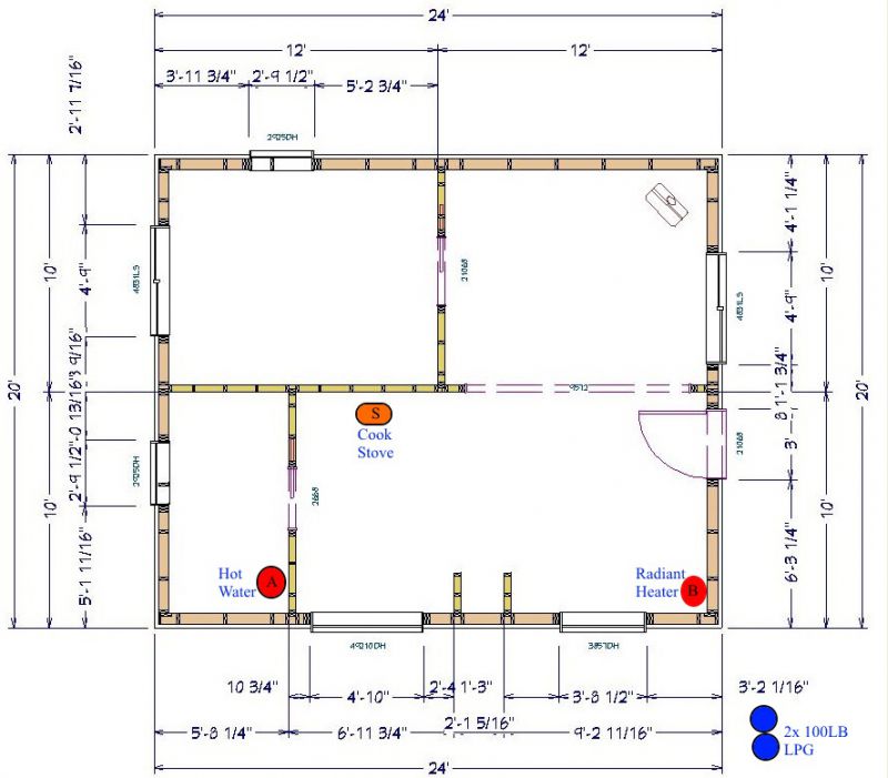

The farthest branch (water heater) will be 25' from tanks, I was thinking of putting the tanks on a pedestal with roof (tailgate height) 5' from the cabin.
The Eccotemp FVI-12LP is for my year round hot water with the Takagi (to be bought) will be for Radiant Heating using Propylene Glycol. The Takagi will be about 8' from the tanks in the SE corner of the cabin. I would have used water for radiant but the potentials of issues in my climate & usage outweighs that.
This is my Floorplan with the points where everything will be roughly +/- 1'-2'. FP with LPG device locations

Steve- to really take a hard look at your pipe sizing needs, we need to know the btus of all the appliances, and a picture of the gas pipe system itself- what the trunk looks like, where the Ts and branches are, and lengths of pipe. Happy to work with you on that if you like.

I Steve- I looked it over quickly and I think you are in good shape except for the first section of line from the tanks to the T that splits off to the radiant heater. That section needs to be 3/4" pipe. All the rest can be 1/2", but it only barely meets th requirements so your system would not be able to accept more appliances later.
You have a total length of pipe of about 30 feet. I'm going to assume that your stove is 80,000 btus, if it's a lot more you need 3/4" to the second water heater. At 30 feet 1/2" pipe will handle 160,000 btus. The stove (if 80,000) and smaller water heater total about that. But add the Tagaki and you are pulling 280,000 btus, way beyond the capacity of 1/2" pipe. 3/4" at 30 feet will pull 336,000 btus, that's why the first section needs to be 3/4".
Hope this makes sense.
Now- what did I do with that lit stick of dynamite?

Bobrok, for a simple small installation just go with the iron and good pipe dope. Pressure test for leaks. I'd test the iron before advancing to the copper.
Then do the copper and test again. Use a good flare tool.

I agree with MtnDon. CSST is for larger installations, like new houses or large remodels, where you have to put in pipe through a lot of walls, attics, etc. It makes installation much easier.
The one thing I'm still concerned about is the connection of the copper lines to the iron. Do they make di-electric fittings for this so the two metals won't corrode each other?
I used to hate pipe dope. It's the gooiest, messiest gunk on the planet. But there is nothing safer and more secure for gas than an iron joint nicely tightened down with messy pipe dope. Sometimes the old tech is the best tech, IMHO.
