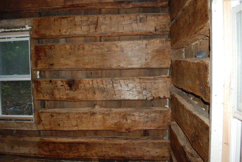

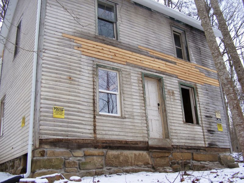

  Our hewn log cabin circa 1870s is under renovation. We're going to keep it clapboard on the outside for cost sake but we're exposing the logs on the inside. Try as I might, mice are still getting behind the logs and clapboard. I've sealed as much as I can get to with no luck. As you can imagine, each log is a highway! My initial thought was to insulate between the logs, then chink it closed with mortar. But then thought why if all they are going to do is nest in it and break it down. What would you do?

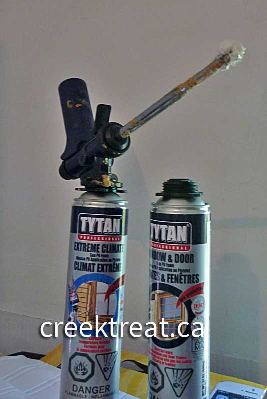

  Creeky what do you mean by "spray gun for foam"?
# Posted: 3 Jul 2015 01:51pm
  i've posted about this a few times.   search creeky spray foam gun
  but a spray foam gun is essential to any self build. imho
  here's a pic of the gun I've been using for the last two years. or is it three. but i picked up this tip on another site and have been using these guys for 6 years now. I'm on my third gun. Hint: get a metal barrel. first gun lasted 3 days. fell off of a dresser and the plastic wand snapped. ouch. then this metal barreled gun came recommended. (HT-300). the first one cost 14 bucks.  i forgot to close the barrel and the foam dried out. this is my second ($19) in 5 years. i'm much more careful now.
  advantages:
   the gun/cans can be used again and again. the can you see here with the gun on it was put on in October of last year. it has been used on at least 10-20 different occasions. the yellow foam on the barrel. that was a different kind of foam. i have put 3 foam types/mfct through this gun. maybe 4. probably 4-6 cans.
  plus the cans last and last and last and ... you get way more applications/foam than single use cans. way more. and yup. i like the tytan product. i live in a very cold climate and sealing a chilly draft at -10 in just a few seconds. priceless.
  having one of these handy at all times is one of creeky's top off grid tips. i'll put something up on my blog about it.
