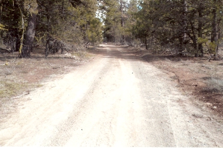

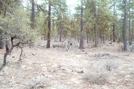

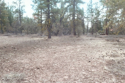

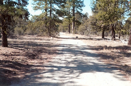

  These pics are more than a year old, but here's my land and the clearings I was talking about:  Lot5_2.jpg

Julie2Oregon
# Posted: 7 Jul 2015 02:32am
  I was going to put my cabin in one of those clearings. As you can see, it's very forested beyond the clearings. So, if they require TWO drainfields (one in reserve), there goes both of my clearings for septic and a lot of trees are going to have to come down for my cabin, other buildings, and fire perimeter.
  Gah, but looking at my land pics, I really CAN'T WAIT to get there!!!!
# Posted: 7 Jul 2015 08:43am
  Looks nice. Are you familiar with the need to thin brush for fire safety? Looks like you've got a buildup of ground fuels. Where I am there is a fire safe council, they organize and finance thinning projects. They just completed 2 acres on my place. I feel much better about my chances to survive a fire now.
