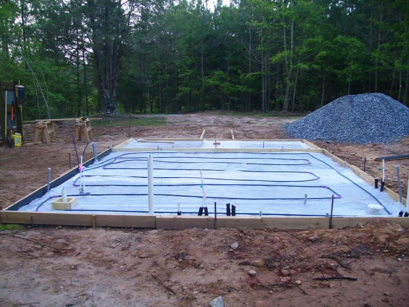

just found this site, have started a 16 x 16 on slab cabin and installed tubing for radiant floor heat, mostly for use while unoccupied to keep inside temps above freezing. does anyone have experience with this?

I'm thinking of building my cabin on slab with 7/8" dia radiant heat tubing. Will this keep a cabin comfortable in 0 degree temperatures?

Under the concrete insulation is of paramount importance. Here in NM the recommended R-value for under a radiant slab starts at R-20. More is always better, at least if you think energy costs will continue to rise over time, as I do.
Radiant is great for maintaining a comfortable temperature in an occupied building. We have friends who bought a used home in the mtns near us. Big thing with radiant floor heat. It is not occupied full time. They drop the temperature to 55 F when planning on an absence of a week or more. One thing I have noticed when visiting them is I can usually tell if they have been there a day or two already or have just arrived within a day or so. The floor is still cold 24 hours after they arrive.
# Posted: 16 Mar 2012 09:05pm
In northern Wisconsin we have friends who put the radiant in-floor heat in so their cabin is kept at 55 degrees while they are not there but they also installed a small wood stove that quickly brings the inside temps up when they arrive on Friday nights. They are very happy with their set up. Good luck!
