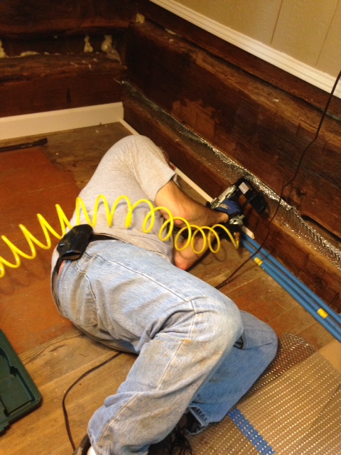

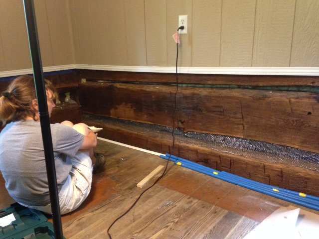

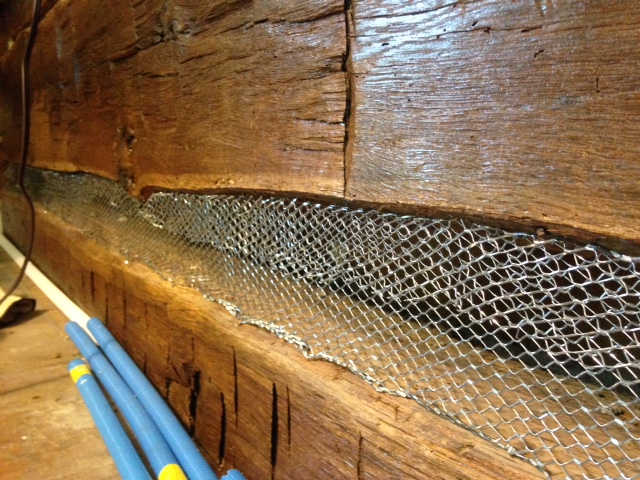

  Got the first piece of wire mesh up. It went pretty smooth and should go quick. Next week I'll try a test strip of chinking and see how it sets up. My mixture will be 1 part type S mortar to 3 parts play sand. The other sand I found was too course and dirty. Keep in mind this will only be used on the interior. Wish me luck!  IMG_0605.JPG

  Smawgunner, you using the "crown" stapler for that? That should make that task go well. Looks good so far. That should keep the pest at bay.
Smawgunner
# Posted: 10 Jul 2015 09:49pm
  Yeah, I bought it just for this application. I'm going to burn this thing up on this job!

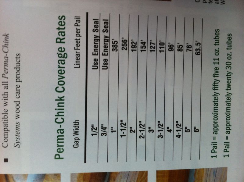

# Posted: 14 Jul 2015 08:28am
  Here is the info on coverage from Perma-Chink brochure.
