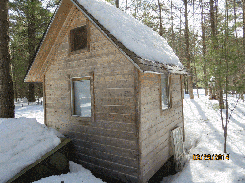

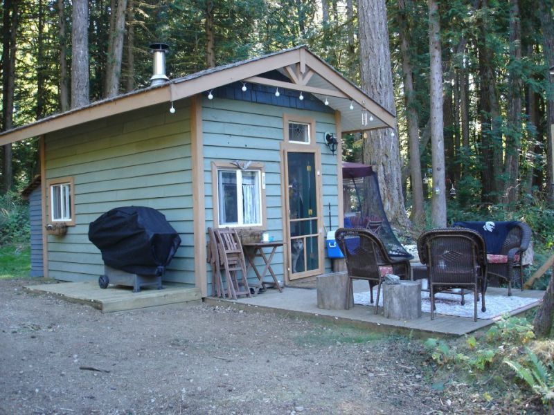

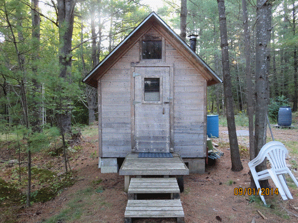

  So after a year and a half, the novelty of the 8x8 hobbit home we inherited is wearing off a little (OK ..a lot!)
  Since it's mostly just the two of us and our dog, we don't need a lot of space but would like to at least get to a 12x8 which we could make work with a murphy style bed and loft space for storage.

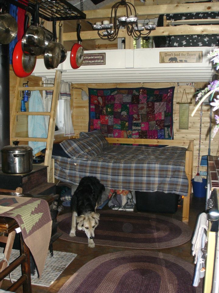

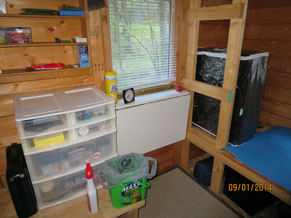

  Looking at the cabin head on, our thought is to extend out from the left side as there are no trees in the way. Ideally out 4' with another door leading to a screened porch area. In the picture, it's the side with the window leaning on it. Inside pic included as well that shows the fixed bunks that take up most of our space.
  As a certified hack I will need to enlist the help of a local expert to accomplish this so I would love to hear your thoughts and suggestions so I can be better prepared as we get quotes.
  Plan B is to tear down and replace, Plan C is the old standby of plunking down an RV and use both.

  How about making a "T" with the 8x8 being the "I" and going 16w x 8d across the back ?  Or even as an "L" configuration.
  From these pics, it's hard to tell how this was built.  It appears to be 2x6 T&G siding with 2x4's around the windows & door.
  Would you need permits or not ?
  Plan B would be best as an Incorporate / Recycle (I hate tearing down and chucking unless absolutely necessary...)  too much waste in this world already...
  Plan C may work but would likely frustrate you to death in a year or so... but as an interim while adding on / improving may work out the best....  More you do yourself the more you can save and build bigger or better for the same $.

  i would not touch that building. it's a beaut. really. somebody did a careful amazing great job of building that cabin.
  why not do a second building? not be be indiscreet but I have 4 buildings. wait 5 now.
  a friend of mine who I talked with this a.m. about his laneway has 3. over the past few years of discussion he's decided rather than try to make their really lovely main cabin manage a new "later in life" bedroom. they're building another small building. composting toilet and a bedroom/living space.
  by the time you tear the roof off etc. a second building avoids all the work of modifying.
  cheaper. easier. more fun.
  okay. that's .04 now.

  @ LoonWhisperer  100 square feet till permit needed BUT you get a touch more if you stick to Metric.
  For maxing useable square footage, consider Round of Octagon shaped building.  You'd be surprised, I was !  Haven't built one yet but it is in the longer term plans, cabin & powerhouse are #1 right now.

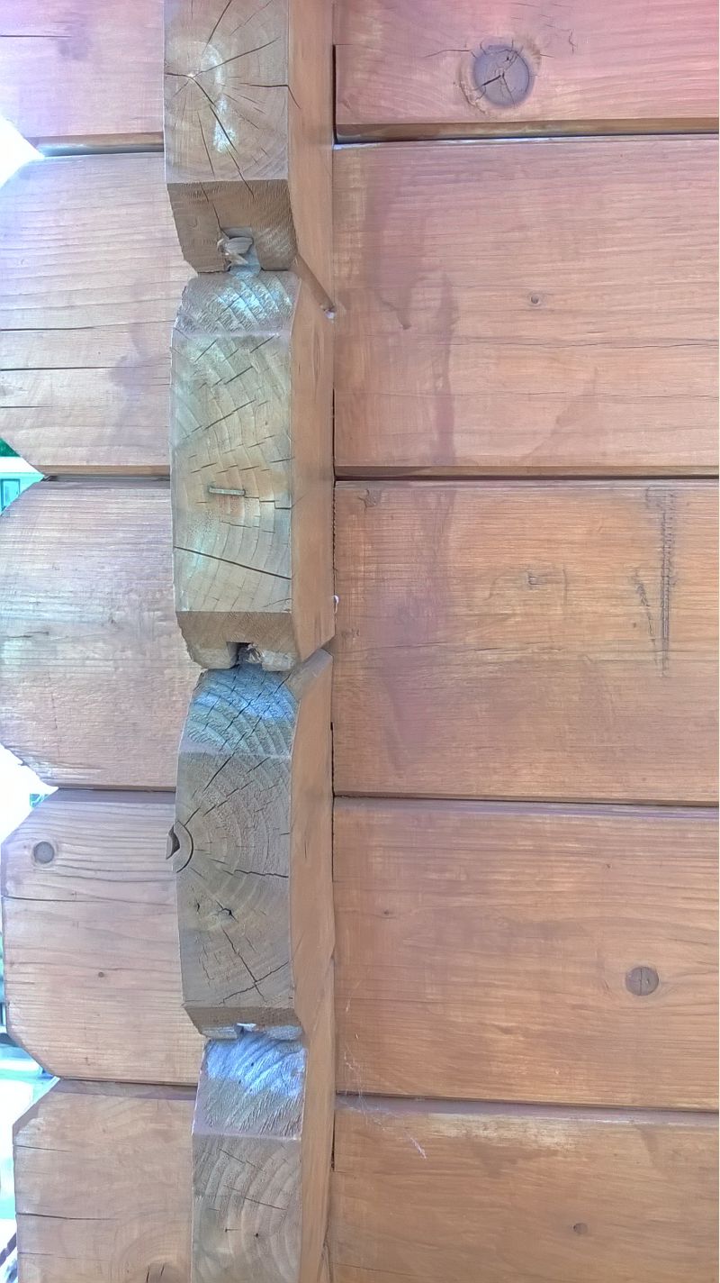

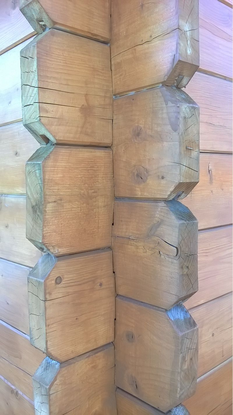

  2nd Creeky as well on the point that the building "as-is" appears to be well built and very sturdy.  BMR Sells a "kit" similar to that built of 2x6 T&G with interlocking corners (pretty spiffy actually) for either $2200 or $2500 (I forget off hand but I think too much).  PICS of the corner detail below.
  Pondering... Looking @ pics again, I count 14 boards per wall plus the extra few on the ends 8 boards up, prolly 4 2x6x8...   64 pcs 2x6x8 ??
  You could pop in a 12x8 behind it and add a 4' Breezeway from the 8x8 to 12x8...   Setup the breezeway with screens and pop-in Perspex / Polycarbonate widows for bad weather times...  Then you get a "kitty Corner" which can give you a nice patio space or spot to put a Gazebo or something.

  Uh-oh. Here comes an architect.........
  It's a beautiful little building. Creeky is right, someone put a lot of care into building it.
  The two main things I see you mention are "The budget is tight" and "We want to keep it under 100 sq'" to avoid having to get permits.
  Adding on to the side will result in an awkward looking cabin overall. A simple, clean shape with a funny little bump-out on it.
  The pitch of the roof is great. Instead of going off to the side, extend either off the back or the front. I would prefer the front. Add another 4 feet in length (adding 32 sq' so the total stays at 96 sq') and then add another 4 to 8 feet further for a covered deck or screen porch.
  No cutting into the roof, no tying in roofs at a 90 degree angle. Just extending the same size, heights and angles of the original cabin. Very simple and inexpensive.

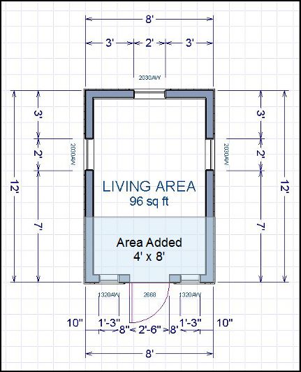

# Posted: 14 Jul 2015 09:26pm

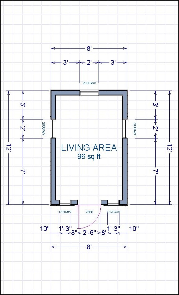

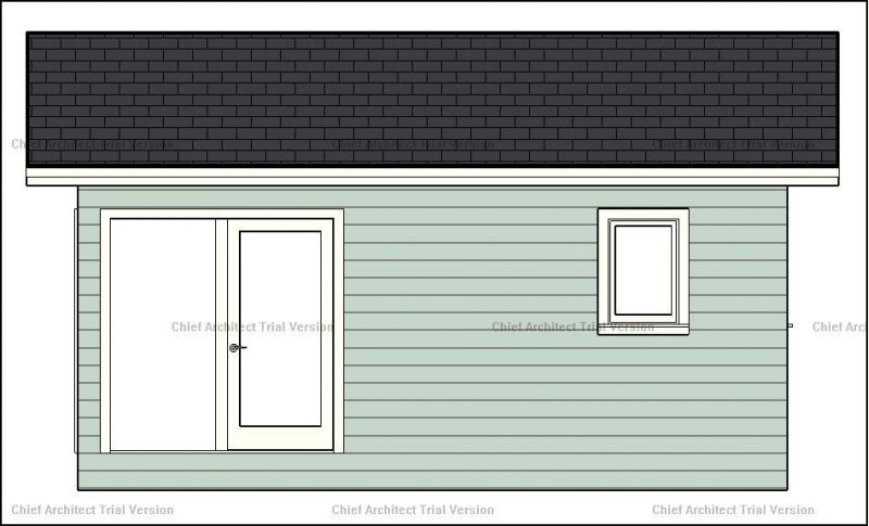

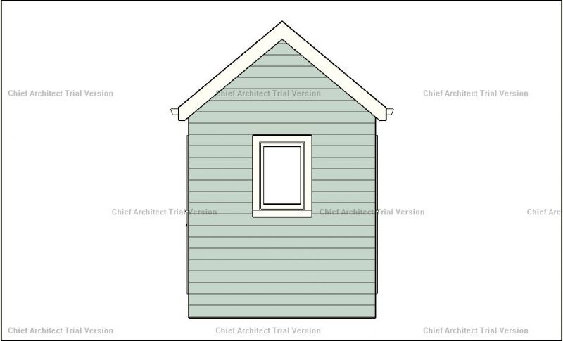

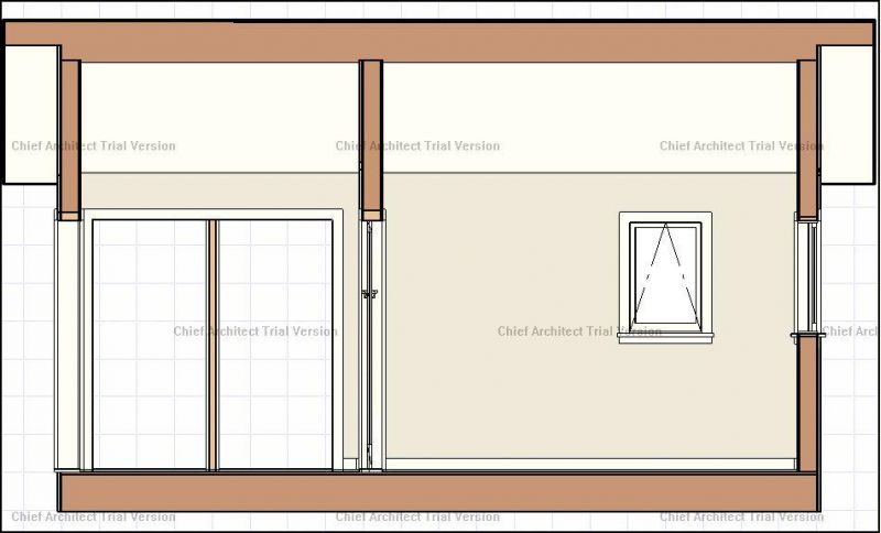

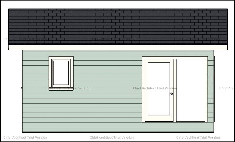

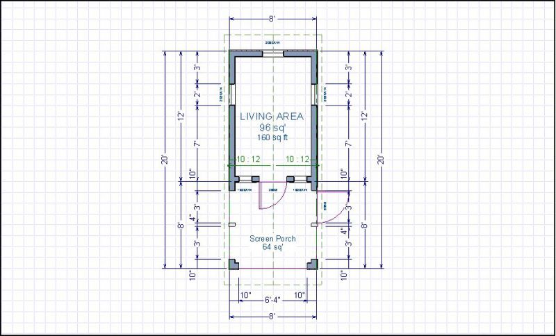

  Here is my idea of what it could look like.  Floor Plan
  |   Close Up
  |   Area Added to Cabin

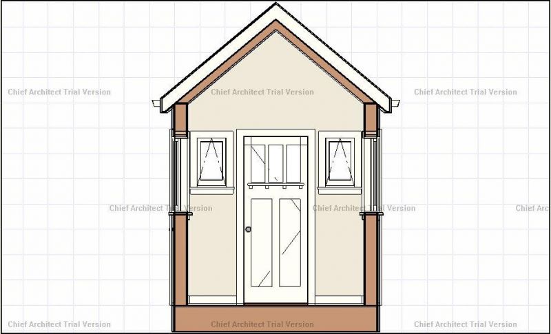

# Posted: 14 Jul 2015 09:27pm

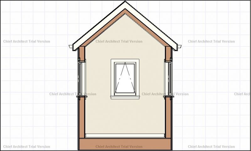

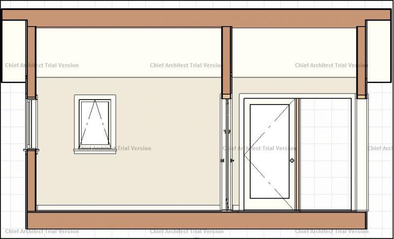

  Sections  Section East
  |   Section West
  |   Section North
  |   Section South
# Posted: 14 Jul 2015 09:28pm
  Porch Sections

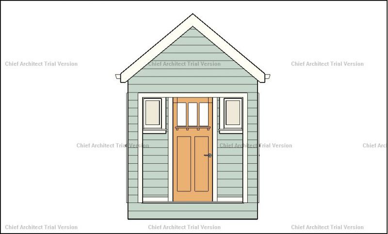

# Posted: 14 Jul 2015 09:42pm

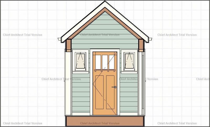

  Elevations
  Of course, your exact cabin dimensions will vary. Basically, I used an 8 x 8 foot square plan and added on a 4 x 8 foot addition, and then an 8 x 8 foot screen porch.
  I did add two small 15" wide by 24" high windows next to the front door just to get some more southern sun. I used a wall height of 8' and the roof slope set at a 10:12 pitch with 6 inch overhangs at the eaves and 1'6" overhangs at the gables. The porch screen door can be placed anywhere.
  All of these dimensions were guesses, (and these may change based on the way your cabin is built), but the drawings will give you an idea of what extending the cabin would look like.
  This is probably the cheapest way to keep the cabin to just under 100 sq'. You can even re-use the materials from the existing front façade - just move the door and the sheathing on either side of it out 4 feet.
  I would probably leave the little exterior "gable" above the entry door in place so as to have a place to attach the roof extension. Look at the roof inside to see how to add on the extended roof section.
  I had a lot of fun drawing this up. Thanks.  East Elev
  |   West Elev
  |   North Elev
  |   South Elev
LoonWhisperer
# Posted: 15 Jul 2015 11:06am
  OK... mind blown!   Thanks Rockies for taking the time to do that.  Now I am armed with some serious intel as we go through the process.  I'm no expert but that sure looks good to me.
  Much appreciated!
