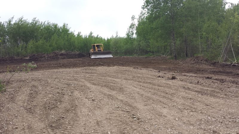

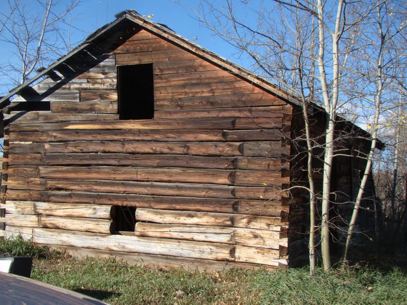

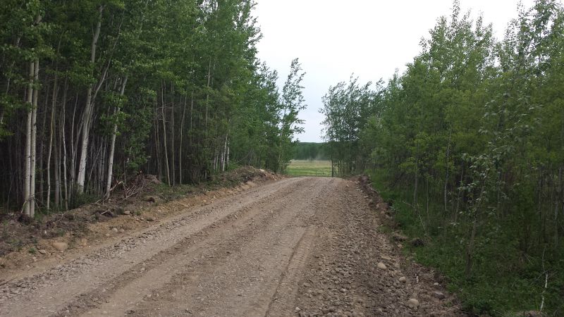

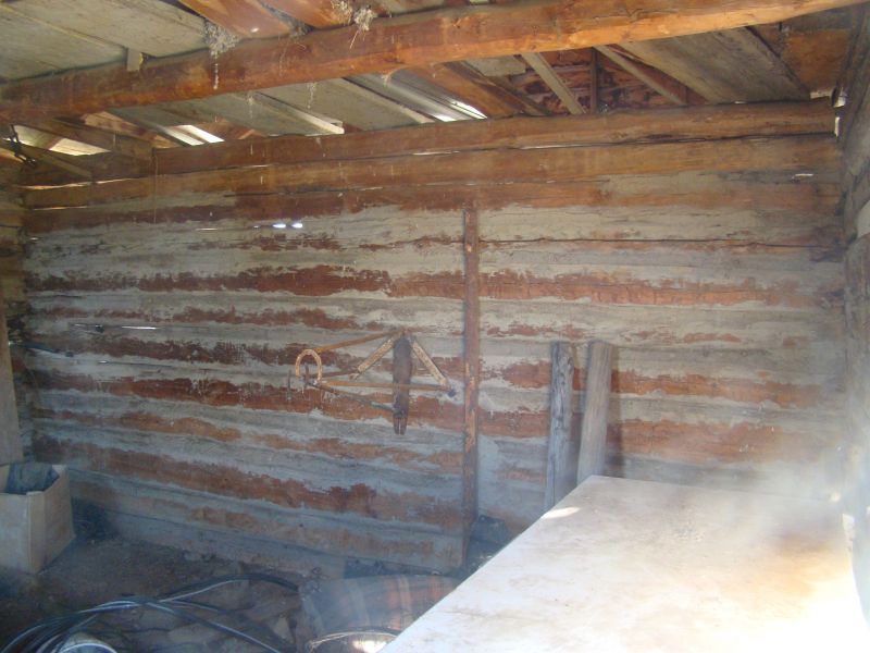

We have recently purchased a 1/4 section of land which we plan to build our retirement home on some day. The property has a lot of potential, especially the current house site which overlooks a creek. It also has a lot of garbage on it (old farm equipment, vehicles, out buildings, etc) which will take some time to clean up. It also has an old log building that we are considering moving back into the trees and then restoring. The problem is that both my wife and I are not what you would call the handiest of people. With that said, we have done some basic research and have had a local fellow who specializes in log buildings to come out and take a look at. He told me that it is built out of fire killed logs which is why it hasn't rotted out. He can also move it for me to where we want to put it. It needs a new roof, new floor, one of the walls need to be stabilized and it has to be put on some sort of foundation. I am attaching a few pictures to show the building and where it is going to be moved to. I am just looking for some honest feedback to see if it is a worthwhile project or if we are better off buying a package to build a new cabin. Exterior Picture

Quoting: moemar1 built out of fire killed logs which is why it hasn't rotted out.
My experiences with burned out forests is that those fire killed trees rot and are attacked by insects and fungi as readily as the ones that die from other natural causes and just as readily as any tree cut with a chain saw. Fire killed trees left standing seem to suffer about the same decay as beetle killed trees left standing around here. Perhaps the species is one that has some natural resistance to decay or to insects? Some insects get into the fire kill before the area has fully cooled after the fire.
As far as moving and rehabilitating I think that is a project bigger than is being imagined considering it needs a foundation, a floor, a roof, some kind of wall work and who knows what other surprises as the project develops. I'd be very careful with the estimating before committing.
Is the idea to restore and use it as the basis for the retirement home? I'd get at least one other on site inspection and opinion and estimate of time and cost. I think I'd want to see completed projects of a similar scale and talk to the hopefully happy owners.
I see Alberta is the location. That foundation will need deep footings to prevent future frost damage.

Thanks for the feedback MtnDon. The cabin has been standing for 68 years (not the 75 that I posted) and built by Polish homesteaders in 1947. It is still very structurally sound with the exception of the south wall which has shifted somewhat over the years.
This cabin would be strictly for recreational use only and as such we would not be doing a lot of the things the more serious cabin enthusiast would consider. Our primary concern is the cost of the project which I know can far easily exceed our budget. I have priced out the roof (tin) at about $800 and the move will be done fairly cheaply. We have a gravel foundation but not sure what type of foundation to put it on. Do you think pressure treated 8 x 8's would work? I know foundations are really important so we may consider other options. We have 4 steel pilings that are in the ground at the house site but are not being used. I know a guy who could yank them out and put them back in for me at a reasonable price. We need to add a few doors, windows, flooring, chinking and know all of this will add up. We have a real cool old wooden cook stove that was in the original homestead + a wood stove just for heating purposes.
