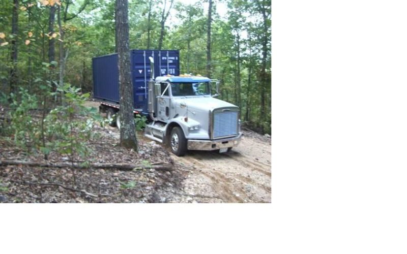

Okay we got side tracked on the security breakins thread so I thought I would start a Container Cabin thread. Right now I have a camper on land and am trying to decide what sort of cabin I want to erect. Everything from an A-frame to log to earth sheltered to stone masonary (slip masonary) to dry stack and Containers. I like the idea of a container house for 2 reasons ..... mice and men! Our land is fairly remote so I worry about break ins. With our camper in the winter we get mice no matter what I do to keep them out. (Non cat lover here). I do have a container I had delivered that I keep my tools, atv's etc in and do like the fact thats its safe each time I get there. Whatever I decide on I would like to do the majority of work myself. Thats a whole other thread as I am a computer guy not a carpenter. The down side of the container idea is the aesthetics. Wife would like that cute little log cabin... of course she hates mice.... but its hard to make the container look rural. Below is my container being delivered.

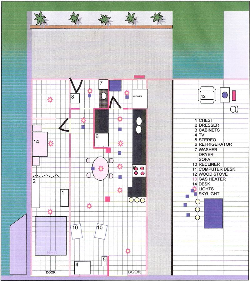

hebegbz
# Posted: 15 Sep 2010 11:12pm
Well in my day we didn't have all that newfangled stuff.
I had to design my cabin in xcel cause that's all we had.
The little boxes are 1' square. The trailers are 40' each and there are three, set so the the doors go front back front.
steveqvs
# Posted: 16 Sep 2010 08:21am
hebegbz,
Very cool design. Creative use of software! Looks roomy. So do you have just skylights? I like that.

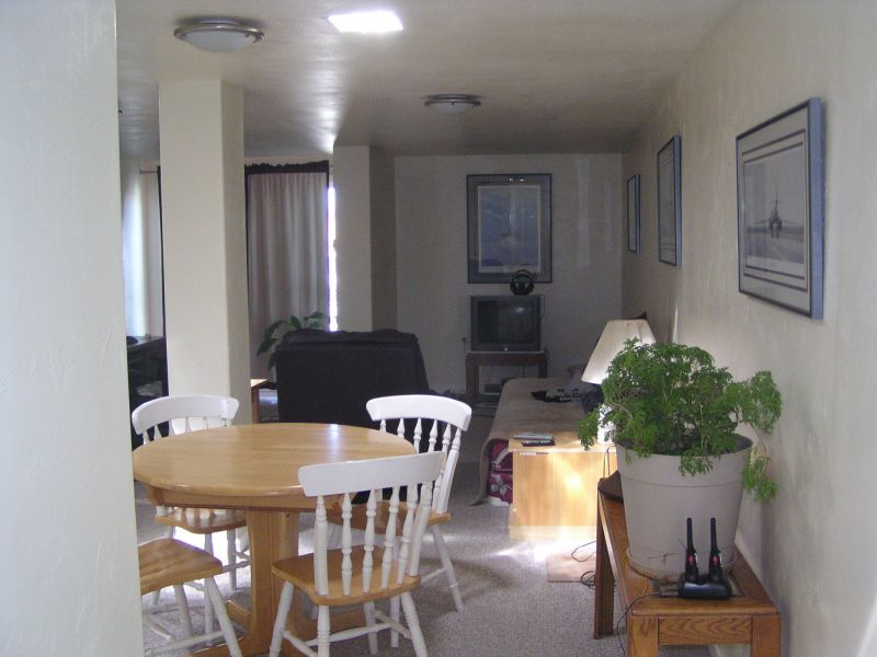

hebegbz

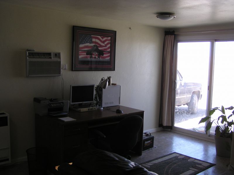

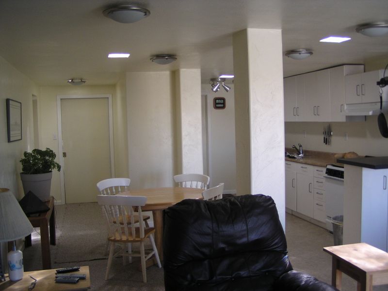

# Posted: 23 Dec 2010 09:07pm
We have lived in 3 40 footers for the last two years. Kinda like a triple wide. This is a couple shots of the front room area.

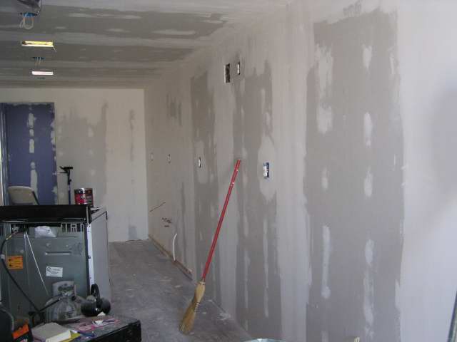

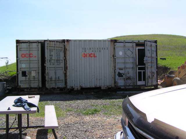

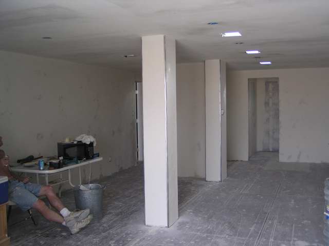

hebegbz

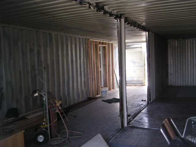

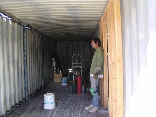

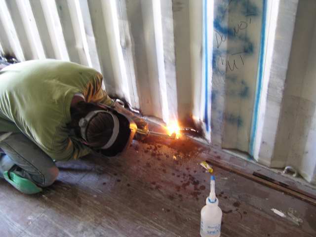

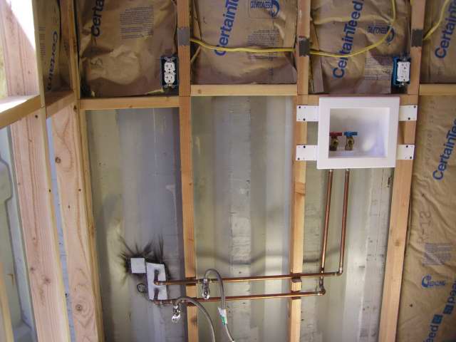

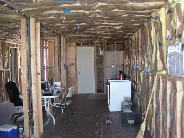

# Posted: 5 Jan 2011 10:02pm
Here's a few pics of construction. My wife and I did everything ourselves.
hebegbz
# Posted: 5 Jan 2011 10:05pm
A few more.

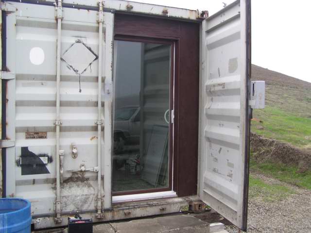

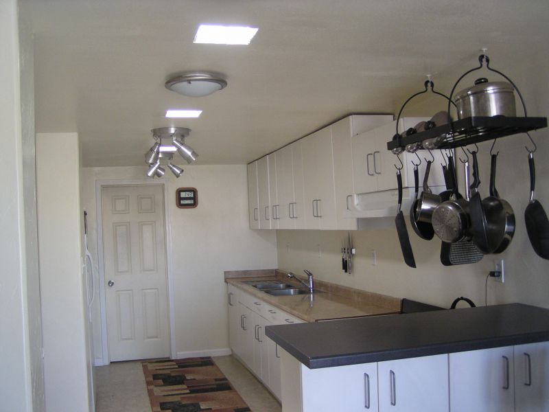

hebegbz
# Posted: 5 Jan 2011 10:10pm
Couple of finished pics

# Posted: 5 Jan 2011 10:16pm
A couple more construction pics that I found. Also the blueprint, sort of, that I used to plan the layout.
