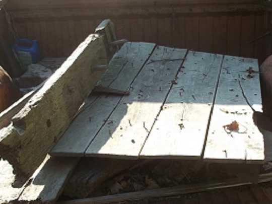

I've attached a pic of a door buck from a spring house, this is pretty typical of old log construction around here. This is essentially what toyota is suggesting, in this case the pegs are driven into each log course. As the corners of these cabins settled the door bucks did not allow settlement in that area. The cabins end up with a hump at each opening and lower corners.
Another way is to insert blocks in the gap between rows and slot the bucks into the log ends at the openings, or slot for the nails... allowing the logs to settle as they shrink, the blocks preserve the gap, which will grow narrower at the corners than at the blocked openings but it will be closer than the rigid connection because it does allow for log shrinkage settlement. The top of the buck is left several inches short of the top of the rough opening and trim is designed to cover the gap and allow the logs to settle
The bucks can be slotted for nails with a washer under their head, or they can have angle iron set in a dado so that the leg of the angle slides into a groove cut in the log ends. I like that approach because it really holds the logs in line but allows them to slide down freely. You can also nail a 2x2 to the log side of the buck and cut a groove in the logs to slide down that 2x2.
