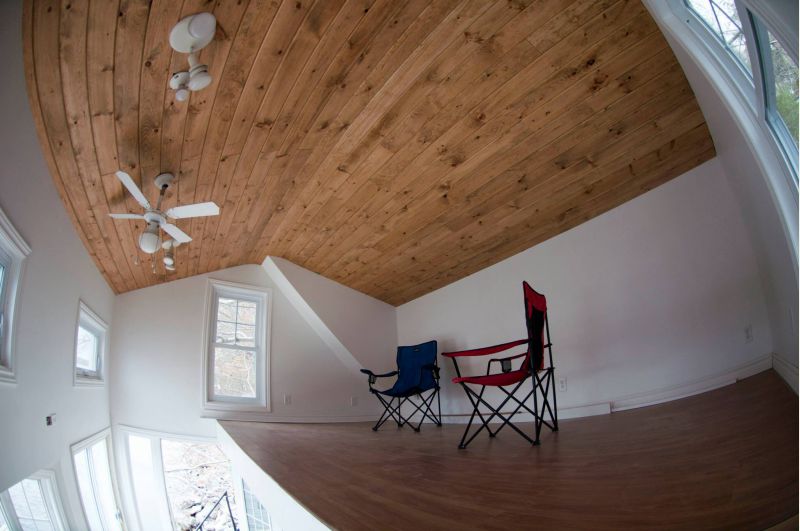

  I used 1.5" into ceiling & wall studs/rafters w/o dry wall. Has held nicely for 5+ years in a cabin that goes below freezing for weeks at a time. Mostly nailed the tongue with a few face nailed where there was limited space. I did mine with hammer... so an occasional hit finger was the only damage.

  I used 16 gauge 2" nails into 2"x6"s ... worked like a charm and super easy to put up. If going through drywall, just use the longest you nail gun will take. P.S. I pre-finished all the wood before putting up (as suggested above)
