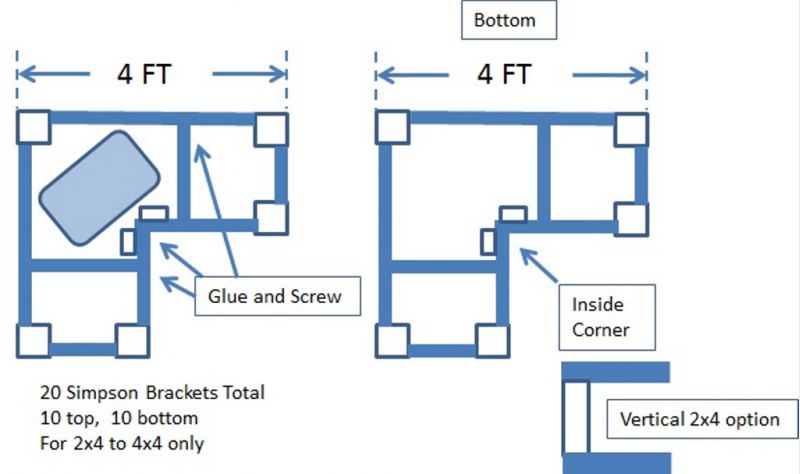

DaveBell - do you have a picture of you setup? It might help me understand a couple of you instructions. Particularly the 3 below:
Connect 4x4's all the way around with 2x4 and brackets, top and bottom. (Build away from wall, slide into corner later) Use a level. Do not mount brackets past outer edge of 4x4's.
Four feet minus 2 each 4x4 = length of 2x4.
Extrapolate same calc for short sides.
Inside 4x4 corner to back sides, install 2x4 front to back, top and bottom. Like this "V" but square.
# Posted: 14 Aug 2015 05:14pm - Edited by: DaveBell
Frame
The only sucky thing in this pic is the vertical 2x4's on the inside corner, they would interfere with shelving. If you can, put them between the top and bottom horizontal 2x4's so they are flush. Drill pilot holes at 45 degree angle in the vertical 2x4's then glue and screw. You don't need glue at the 4x4's.
Use a level. (Is critical for the top framing so that the counter top has a level base to sit on. You don't want any 4x4 to be higher than any 2x4. It's okay if you need any top 2x4 to exceed the top of any 4x4 because it is a larger surface for the counter to sit on. Any small leveling error on the top framing of less than 1/8 inch will be remedied with the construction adhesive that you will apply in 1/4 inch bead. All the top 2x4's need to be level with each other in all directions so you need a 4 foot level.
Do a test mount of the counter top to the frame and look underneath for any unsupported areas around the perimeter. )
If you end up with a top leveling problem, you can use wood shims (from the store) between the counter and 2x4's before the adhesive.
Do not mount brackets past outer edge of 4x4's. You will see what I mean when you see the brackets. The brackets have flanges for screws.
I deleted a 4x4 at the inside corner so the count is 5 4x4, 2 inches shy of standard counter height. I don't know the sink dimensions and clearances.

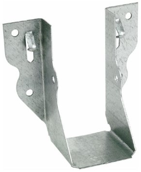

# Posted: 15 Aug 2015 03:54pm
Simpson LU24
# Posted: 15 Aug 2015 03:55pm
I think the Simpson LU24 bracket is the one I used for 2x4s.

# Posted: 17 Aug 2015 09:09am
Thanks DaveBell for the picture and instructions. This helps a lot.
