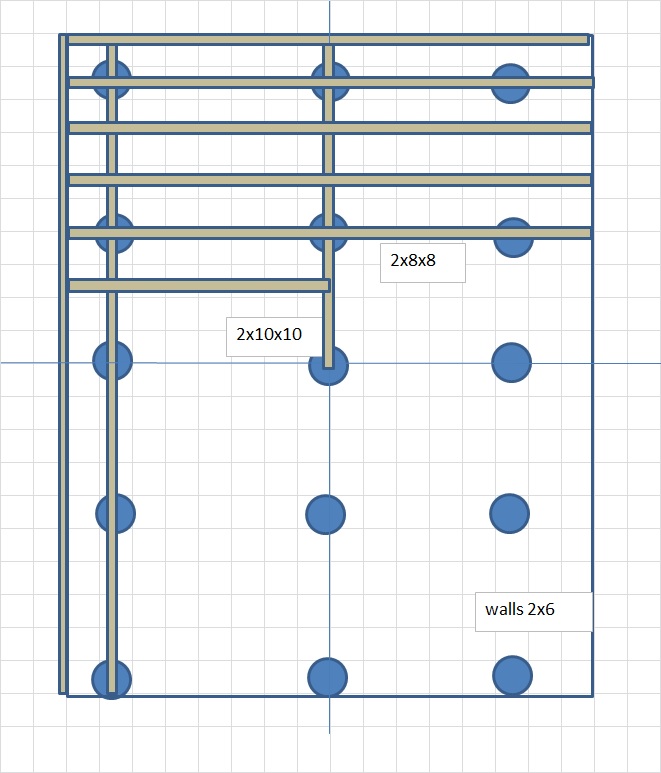

Sounds like you need to do concrete piers below the frost line and 2' above grade. You could use those Quik-Tube with bags of concrete, mix onsite with the clear lake water. You don't have to do all of them at once.
Potable means you can drink it. Like Steve said above, it just needs to be clear. No mud, no leaf matter, no salt.
Layout your pier plan with string, and start digging. Look at Google Images for how to lay out piers.
Draw something like this and have it approved before starting. Look at Simpson Strong Ties for Piers before beginning.
The Quik-Tube needs to extend below the frost line and 2' above grade for your local code. Visit your local building code approval folks, they probably can help.
