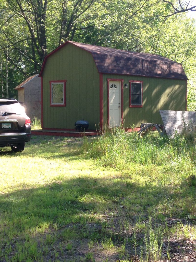

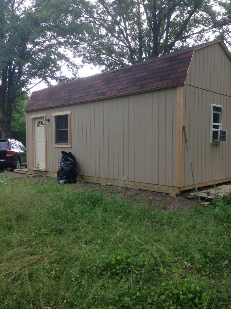

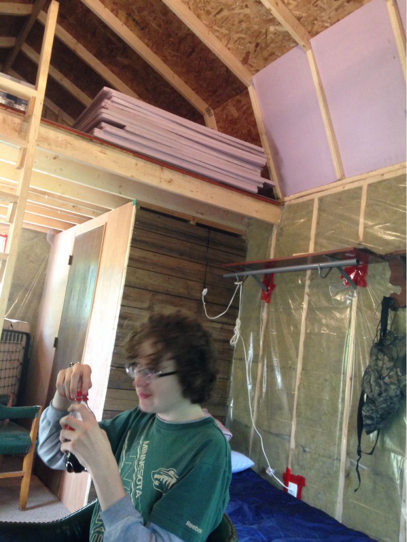

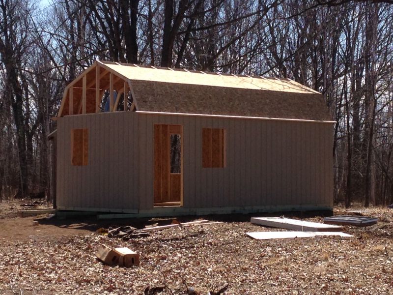

Here's a picture of my 12x24 lofted barn that was built on skids. Pretty happy with it so far. Extended skids out front 4 feet to make for an easy deck addition. I went with a higher barn to get some decent storage and sleeping space in loft. Don't think I would want to go much bigger than this.
