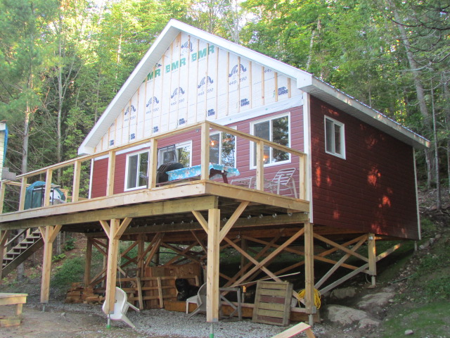

Hello, Would like to build a screen porch of 12X10 on my existing deck. The deck is 30 feet wide and 10 feet deep. I have 3 windows and a patio door. My questions pertains to where do I put the posts for my roof ? photo shows where the posts are under my deck. i don,t want to have the post for the roof in front of a window because i will be closing the porch with walls.the screen

# Posted: 7 Sep 2015 02:19pm
With a 10x12 you can get away with 2 posts if you use a large header like double 2x10, unless you have a large snow load. The more difficult question is how are you going to structure the supports for the screen to not interfere with the view, ive never seen screen in a roll wider than 4', but maybe they make it... Also you can reinforce under the deck to make ample support for the posts.

Hello Pash, you suggest i reinforce under the deck , so not sure what you mean by that?
my major concern is that one of the roof posts will not be aligned with the deck posts underneath because of the window where i want to make the side wall. i have to move it over a bit. should i add a post under the deck just for the roof post? i am trying to avoid that.

pash
# Posted: 7 Sep 2015 08:59pm
What i meant by that was double or even tripple the floor joists under where the post will sit. Then you can just use a simpson post bracket on the deck floor to attach the post.

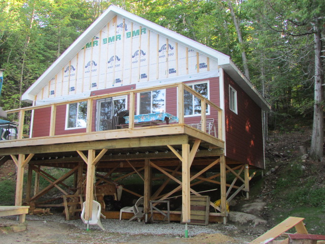

# Posted: 13 Sep 2015 08:02pm
Are there metal brackets connecting the tops of your deck posts to the beam? I can't seem to make out any. If there aren't, it means just a few nails are holding those posts in place, and one small cross brace angled back towards the cabin is all that's keeping the beam in place. Are you planning on beefing up the bottoms of the posts, because it looks kind of odd with them standing 2 feet off the ground on those metal posts. Which side do you want the screen porch on? In front of the two smaller windows, or the one window and the door?

# Posted: 13 Sep 2015 09:41pm
Hello rockies, yes, there are metal brackets connecting the tops of the the deck posts, they are on the other side where you can,t see them. The screen porch will be in front of the two small windows.

# Posted: 15 Sep 2015 07:50pm
Thanks for the info. First I would continue the beam that rests on top of the front four posts around the side of the deck and back towards the house. Even though the deck is structurally sound, as it looks right now the side appears a little "skimpy". It would just appear more "solid" if you had the side profile look the same as the front, then cut the side brace and make it look like the front braces as well.
That said, it appears that you could continue the corner post and the post with the chair leaning against it upwards to support a shed roof without the posts interfering with the views from two small windows. The new porch posts would have to rest on top of the lower deck posts so that the point loads go straight down to the ground. Since the front wall of the porch would now be set back from the deck railing you could either remove the railing in front of it, cut back the deck floor to the beam, or leave the deck as is and put low planter boxes on the edge of it.
A smaller post could then be put into the center of the new screen porch facade in order to divide up the opening and give you a place to attach screens. This smaller post looks like it would be centered between the two small windows so that it didn't block the views from the windows. You might also consider skylights centered in front of those windows for added light. I take it the shed roof would slope down towards the long edge of the deck? it should be a problem to attach it to the gable.
