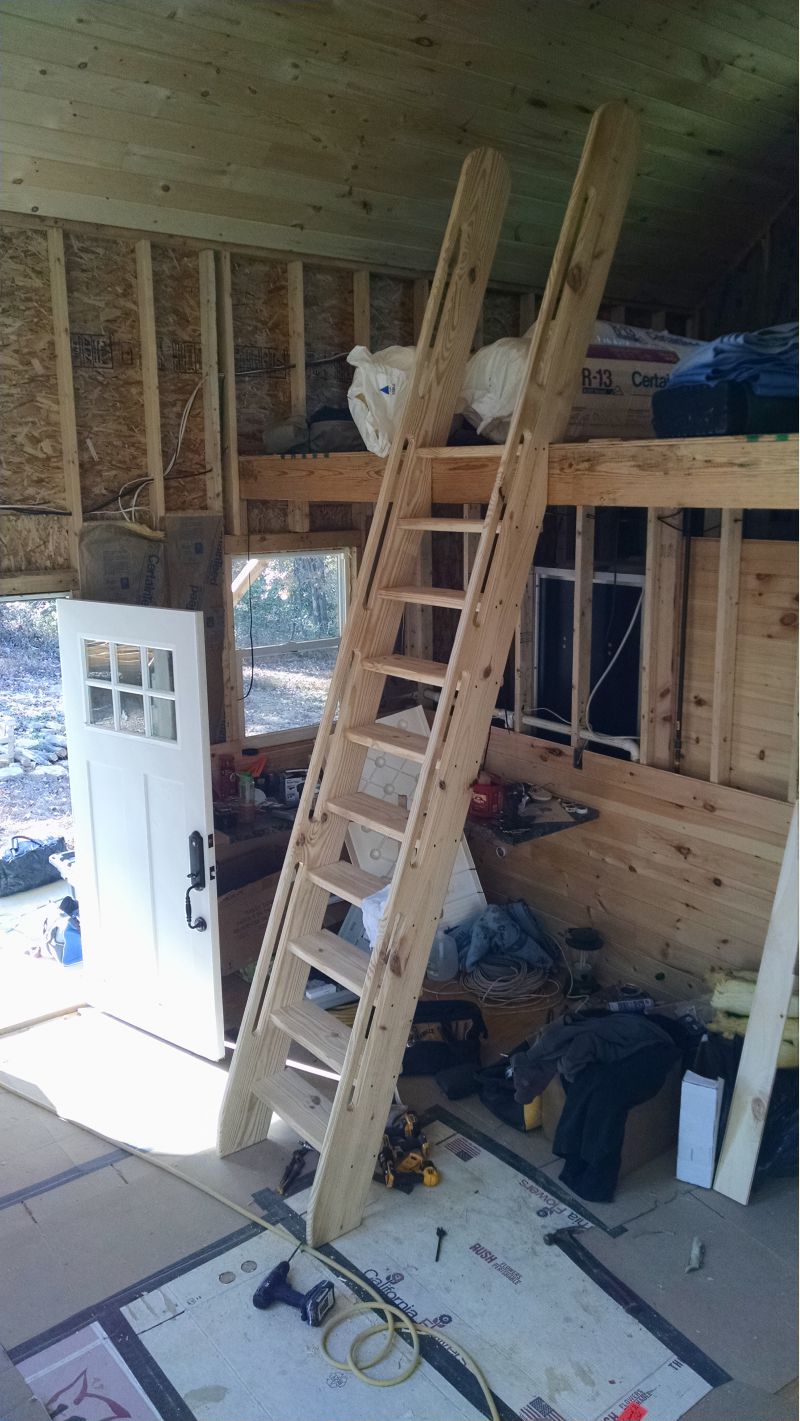

  So I am struggling with what type of ladder to use for my loft.  Originally I was just going to put in a ladder using 2x10's and route out handles.  It was going to have a slight angle versus straight up and down but we were worried about it taking up room on the first floor.  So we changed our mind to an attic ladder so that it could be closed up and out of the way when not needed.  We didn't want to cut a rectangle hole in the loft floor because we didn't want to take up space there as well so we are trying to come up with a way to mount it on the outside area of the loft.  One long side of the ladder frame would be mounted against the 2x8 floor joist and another short side would be mounted to the wall of the cabin.  The only issue now is that we still have to other sides that need to be mounted to something.  Any thoughts or has anybody seen someone on this site that has done this before?

  Here is the final product and what we decided to do.
