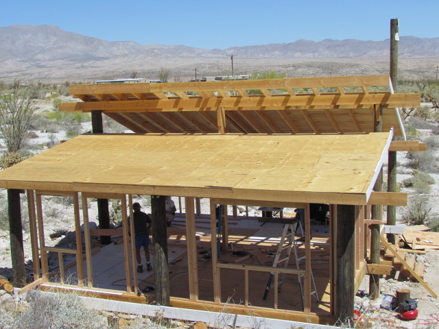

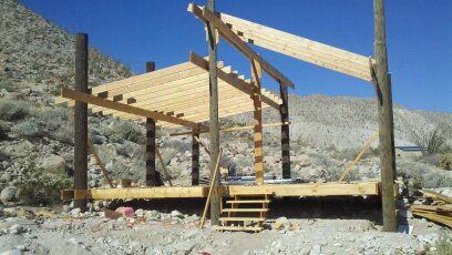

  I like your 'post and beam' concept....It does allow for getting the roof up quickly and move the interior walls anywhere you like. It is a good solution for irregular or rocky sites. I built a 'pole house' which is the same thing. (see pics) 2x6 walls are good, a 2x10 floor with insulation would be good as well. Are you going to pour a perimeter foundation or footings?
