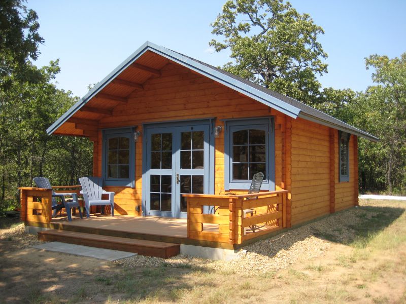

Jabberwocky, my Lillevilla Getaway (220) was easy enough to insulate by using R-Max foam sheets below the subfloor and within the 4 layer ceiling/roof sandwich. Plumbing was all sub-floor with insulated PEX water and PVC drains. Electrical, likewise was subfloor using armored 12ga cable. All was very straight forward and accomplished post assembly (as long as you don't use a concrete slab foundation). I don't live in mine fulltime, but as long as you take the time to weather-strip and insulate, I can't see a problem with it. I would suggest that you be sure to only consider the models with double-pane windows and min. 1-3/4" thick logs. I have lots of pictures of assembly, plumbing and electrical if you need further visuals. Good luck.

Quoting: drb777 I have lots of pictures of assembly, plumbing and electrical if you need further visuals.
I would like to see them. Nice looking cabin.
