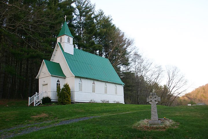

I'm sort of in the same situation. My clients priced windows and it looks like we'll be making them. I delivered the first truckload of locust for sills yesterday. Still up in the air on jamb and sash stock. The ~100 year old ones are poplar which I have as well as white oak which is much better for rot but is more prone to checking and moves more. The church we were married in is a small old mountain church paneled in chestnut. The windows were out of it but the local assembly had begun restorations of the building. I was working in a millwork and cabinet shop, my boss actually suggested the chapel, so I could grind matching knives and donated the windows. LOL, so I'm slow... 32 years. I hadn't thought about it, he set me up, but in a good way. Ah, just found a pic online.
