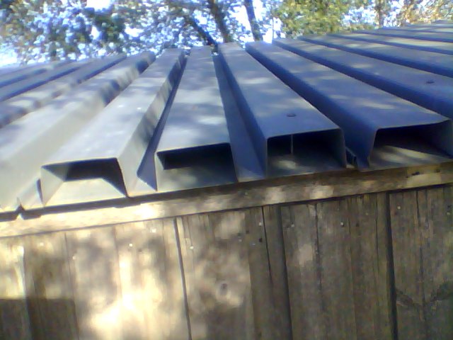

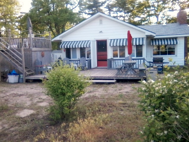

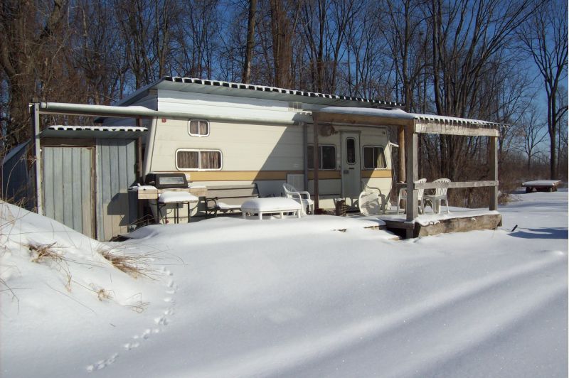

  In the first pic you see my bike shed at our cottage with a deck on top.It has a fall of 2in. in 10 ft.. that dose not seem noticeable to me , seems to run any rain off quickly .  The roof has a layer of industrial roof deck as a structural layer then a pt. deck built over it  5\4s x 6 in. In the second pic you can see I used the same roof deck to cover our old trailer we use as a hunt camp . I purchased the metal as scrap so I have no idea of a price . I was told it is used as  roofing in flat roof industrial buildings , comes in different gauges and lengths .  flat roof deck

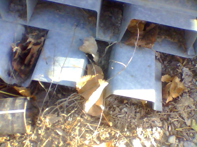

  the metal roofing I used came 2 ft. wide and 10. ft. long it is very ridged has a top corrugated  plate and a bottom flat sheet of steal . The small deck 8x10 has no support under the steel and it is a good solid floor ,no spring .  I think it is made in the US around Baltimore the folks I got it from called it roof deck . Sorry all I know.  Snapshot_20151001_2..jpg

  Looks like pan deck, was it for pouring a concrete deck on?
# Posted: 1 Oct 2015 10:09pm
  I don't know I got 60 sheets at my favorite price .
