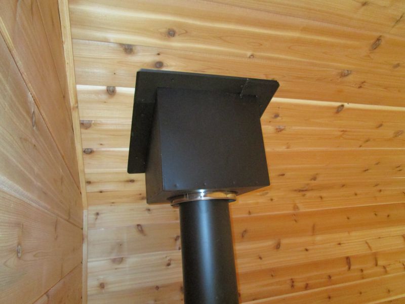

  The support box from Selkirk sold at Menards works great. Just block all around it and Nail or screw from the inside into the blocking. Now the clearances are for their insulated pipe only. Owen  Finished
  |   Two
  |   With glory ring
  |   Stove
