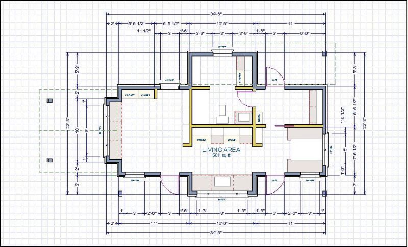

This is the plan that I've decided on building next spring. It will be built in stages as the money becomes available. It only took about 45 revisions to get to this design lol (as you could see in the thread "The First Phase of the Cabin").
The main problem I had was where to put the bathroom? I liked Creeky's suggestion of having it open into the mudroom so that you could clean up immediately after coming inside without tracking dirt all through the cabin.

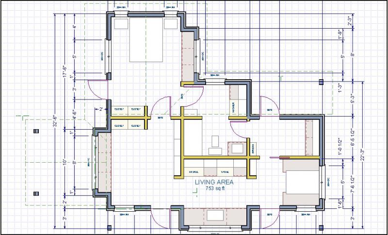

The layout is alright for now since I will be using the loft as the bedroom, but some day I'll be too old to climb up and down a ladder and I'll want a proper bedroom on the main level. The only place to add it is on the north side of the living room, but then to get to the bathroom from the bedroom I'd have to walk through the kitchen and dining area.
Finally, I decided to add to the bathroom now and include a laundry area. When the bedroom is added later, the west laundry wall will be turned into a doorway leading into the bedroom. This way I won't have to walk through the whole cabin and I won't have to add a second master ensuite.
How will you adapt your cabin to your needs as you get older?
Stage 1
Stage 1
Stage 2
Stage 2

Whoa! I haven't seen that plan in a while. Needless to say that isn't the one I'm building, although now that I look at it again it does have a lot of nice features (but hey, I'm biased).
# Posted: 23 Sep 2018 05:52pm
Actually, looking at it again made me focus more on the reasons I rejected it. When I first got interested in designing smaller homes I focused mostly on square footage figuring that just making a house smaller would make it a lot more efficient but lately I've been analyzing floor plans based on function.
One of the great resources that has helped my with this are the Sarah Susanka series of books based on the "Not So Big" design and building concepts. She really zeros in on what is needed in each space and what isn't needed (mainly more space).
So in this plan, although it has individual spaces for each function (like living, cooking, dining, bathing, sleeping, entry, etc) and lots of storage I don't like that you have to walk through the kitchen to get from the entry (in the upper right corner) to the living room.
Also, until I build on the bedroom I'll have to use a Murphy bed in the living room and will have to walk through the kitchen, dining area and entry to use the bathroom.
Every plan has a flaw. Some are minor but others will irk you every single day. These two flaws killed this plan for me.

The problem is being an architect. No matter what you design you see something on another site and want to include it. My cabin plans have gone from 400 sq' to 1000 sq' and back again. It's now sitting at 636 sq' which is really around the best size I think.

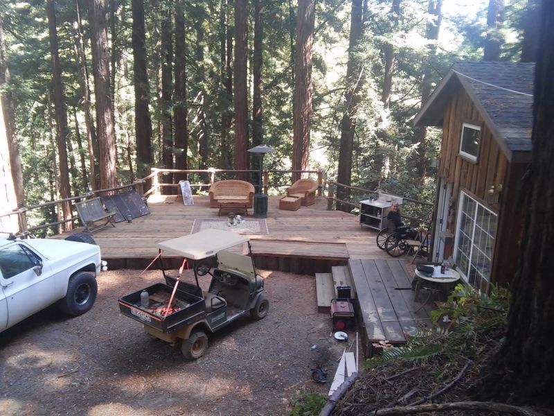

As some may have gathered, my wife has been wheelchair bound for most of her life due to a teenage auto accident. Obviously this necessitates an open floor layout, wide doors, ramps..
One thing I've learned over the years is, in addition to creating space for her to get around, I need space and ways to get around her. For example, I have two doors from the cabin to the deck, so if she is sitting near one door I can use the other.
fiftyfifty
# Posted: 25 Sep 2018 09:25am
That deck! Those trees! Wow!
