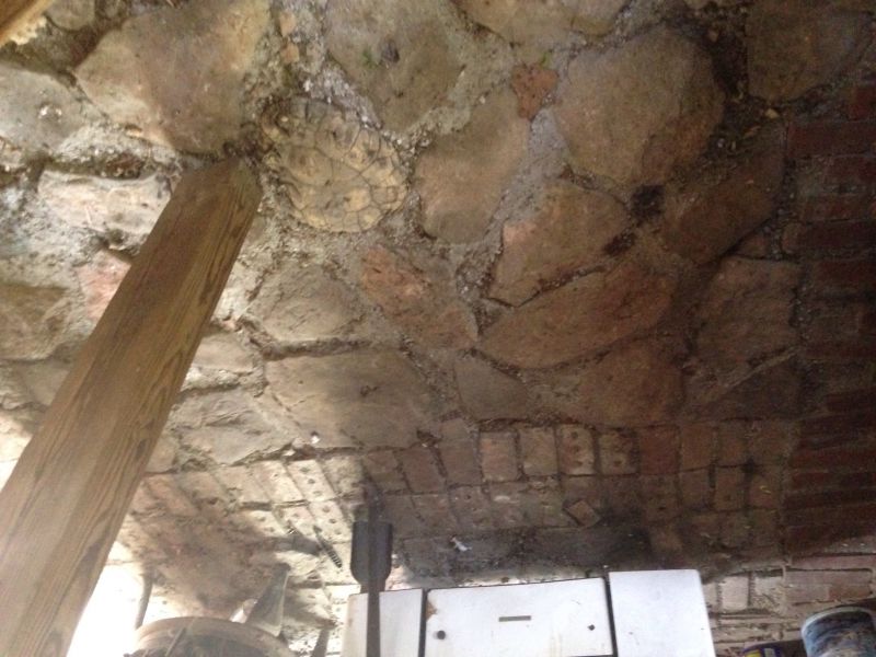

  On my cabin we laid field stone directly on the dirt floor. Then I dumped dry quickcrete on it and swept it into the cracks. I took a hand pump sprayer and wet it down. It set up good and was a huge improvement over the dirt floor. It is rough and not very level. I think if you had a flat field stone it would help, a pretty flat rock looks a lot less flat when you put it in a floor.

  The field stone in the Ozarks is not flat either, which is why I am considering cleaning up the edges with a diamond grinder, To try and avoid the treacherous hip shattering mine field.
  I was planning on finding a lot of little stone the for the base layer, then inch minus follow by the limestone set in place with mortar.  Then hitting it with the diamond grinder.  It is good to hear that other people have tried the same idea, which means I can not be too far off.
  The pic was a big help.
