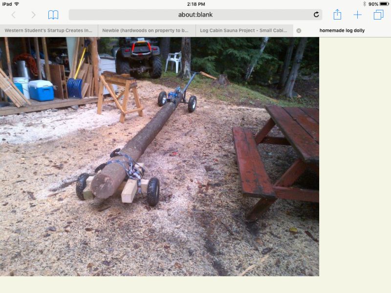

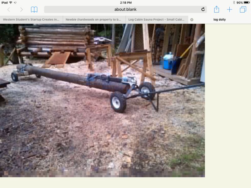

skootamattaschmidty
# Posted: 15 Nov 2015 02:21pm
I made a log dolly that worked great. I used a 4x4 frame for the back and a trailer dolly at the front end. I took a piece of channel steel and attached a hitch coupler to it. It worked quite well and made it easy to move logs by myself.
