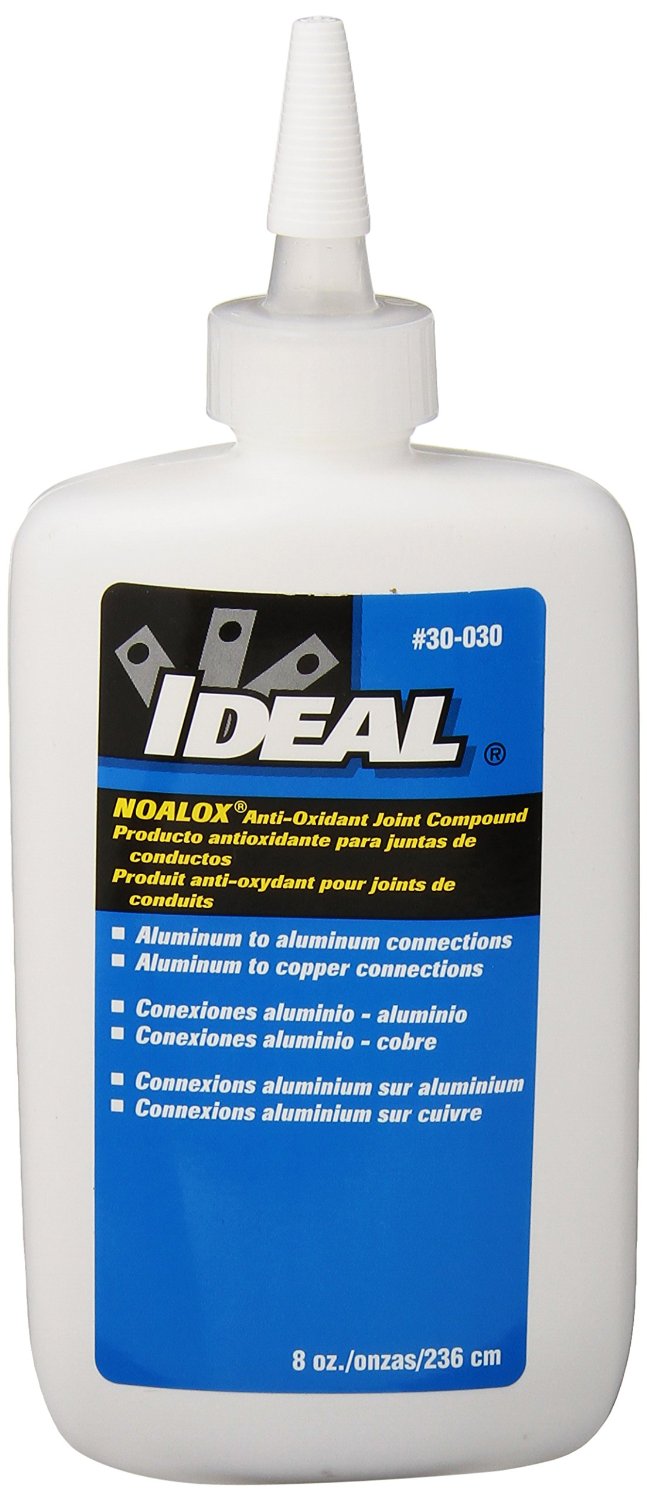

# Posted: 4 Nov 2015 07:56pm - Edited by: toyota_mdt_tech
Steve, is that wire aluminum? I know many times, heavy feeder, AL is used vs CU. Copper would also be much more $$$, maybe that was the heavy price????.
For the OP, if you do use aluminum wire (heavy Gauge stuff) make sure you coat the wire ends with the special additive to prevent corrosion where the AL wire meets the CU panel. One company that makes it is "Ideal" and its called Noalox
Amazon has it also.
