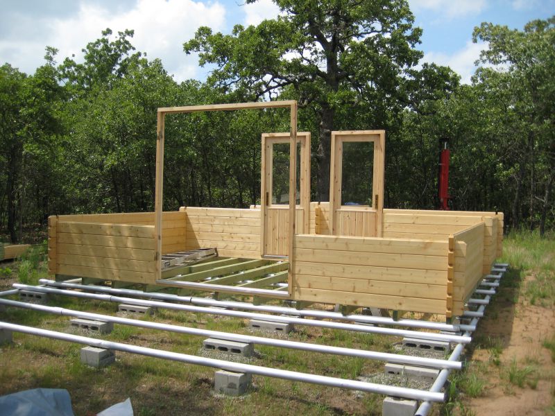

  Quote: "The homes are also built on "skiddable" foundations that allow them to be easily moved or adjusted as the permafrost they rest on shifts."
  This "style" is an oilfield adapted method, made commonplace since most oil and gas operations are temporary, needing to be winch-skidded & truck hauled. And because surplus pipe and welders are integral to the business.
  I also used this method for my cabin for the strength, durability and low cost. Not practical or cost efficient for most, but it worked very well for me.
