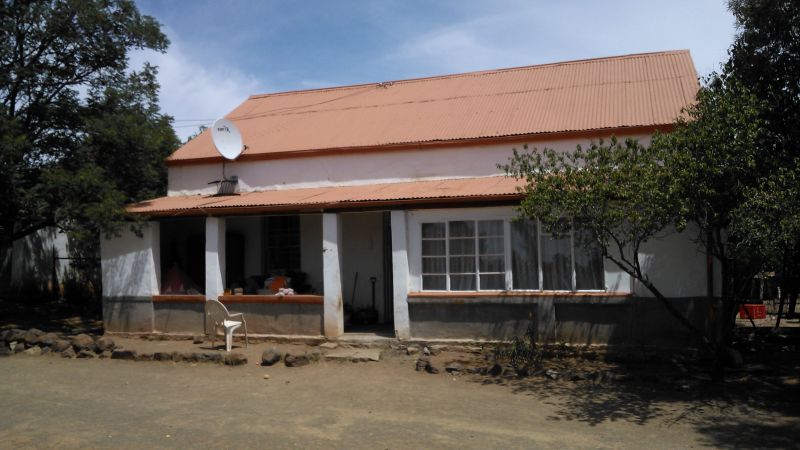

I just bought a very old house. It must be one of the first houses in town built around 1850. Raw bricks, Douglas fir floors and ceilings.

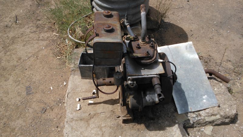

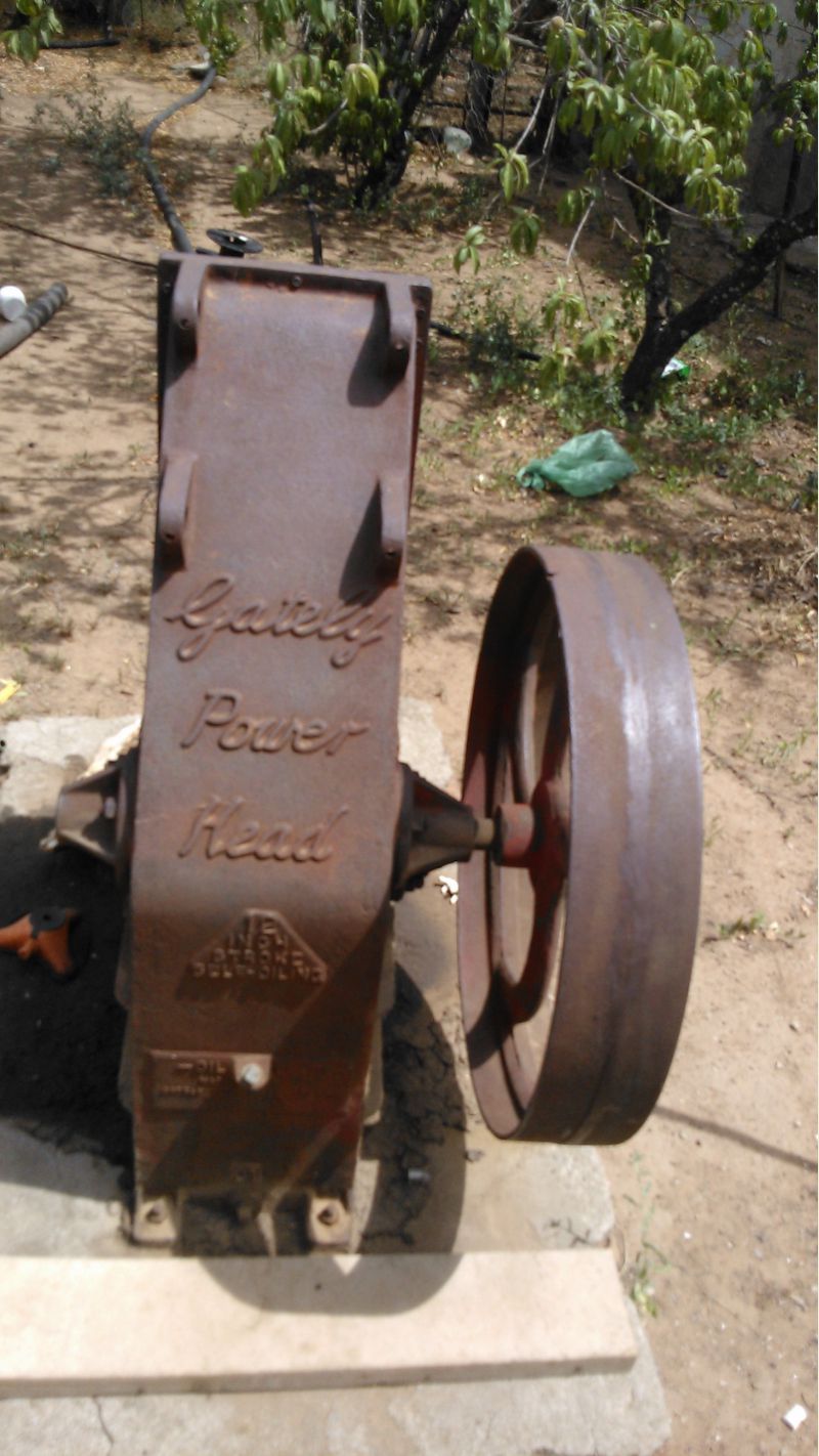

It has a strong borehole with old power head pump and I think it's a Wolsley engine.

Cool, so how is it built? It looks like the exterior is stucco over the brick? I don't know a Wolsley engine, it resembles one of our old Maytag washing machine motors, kick start on one side with a large flywheel, magneto on the other.

The walls look like raw or semi baked bricks built with soil and plastered outside with lime. I don't think they had cement here in those times. Inside walls plastered with soil and painted with lime.
I am still using a lot of whitewash lime to paint buildings on the farm. I mix it with a latex bonding agent and then it lasts for a few years.
The Wolsley engine is a British paraffin engine. There were many of them on farms. The Gately power head pump I don't know. I know a National and a Rapid power head pump, but not this one.

I googled Wolsley engines, an interesting company and history. The Gately didn't come up in a search.
So there must be old lime kilns in the area. Portland cement didn't find its' way into common use here in the mountains until around the time of the second world war. Prior to that it was lime mortars and plasters. I know of two old kilns for burning lime in the area. Its' product was quicklime, a very hot product.
My Dad still remembers the tail end of those days. The burnt lime, very caustic, was brought to the jobsite where a pit was dug and the lime was mixed with water and allowed to slake for as long as possible during the course of construction, the longer the better. The old timers here call it "slack lime" but it is really slaked lime. After it is applied, and here the low fired bricks were laid as infill between the posts and beams of a timber framed house, this is known as noggin(g), the plaster was applied to that brick backing. After the plaster has dried it continues to cure, absorbing carbon dioxide from the air to again begin forming calcium carbonate, limestone. Lime renders also pull moisture from surrounding wood and tend to preserve the wood where Portland keeps wood damp and does nothing to help preserve it. The death of an old log cabin here is often the replacement of lime based chinking with Portland based as rot sets in.

The engine is actually a Vetsak WD9. It is a Wolsley assembled under licence in South Africa and named Vetsak.
