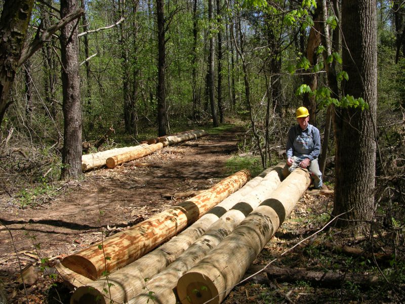

I talked with a cabin replica builder at Colonial Williamsburg in Virginia. He told me the colonials used whatever wood they had handy, except for in-ground posts. Those often were black locust, impervious to rot. Roofs should be cedar, etc. The only straight trees of any size on my North Carolina property are Virginia pine and poplar. So that's what I'm using. See old guy with the drawknife in the pic. If you keep your logs off the ground they will last. I lived most of my life in Alaska, where there's an old saying: A man who builds a cabin out of poplar will die in it.
