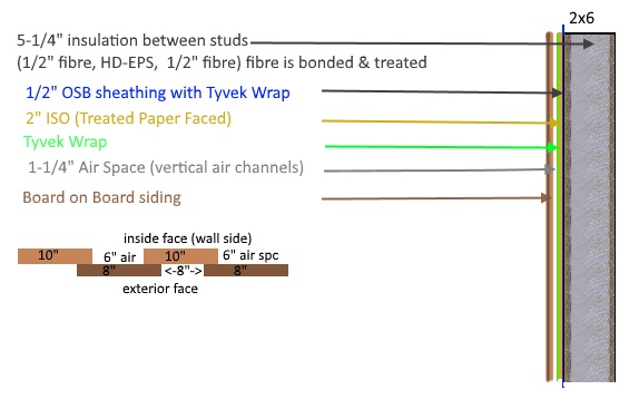

# Posted: 16 Dec 2015 09:32am
I'm going with a hybrid "Perfect Wall" mostly due to the materials I was able to collect. Below is a diagram of my wall structure.
2x6 walls @ 24oc:
Between studs: 5-1/4" Insulation Panel which has 1/2" Bonded treated fibre on each face with high density EPS Foam in between. This stuff has an R22 insulation value.
1/2 OSB sheathing on the exterior, covered with Tyvek, then 2" paper faced ISO (R10), covered again with Tyvek, Horizontal strapping, to be finished with Vertical Board on Board rough cut presenting an 8" face. This allows for an active 6" air channel flowing up and air space provided by the strapping so none of the board is actually directly against the exterior wall insulation.
The Tyvek I am using on the walls is the breathable variety which sheds water...
My Hybrid "Perfect Wall" Design

# Posted: 16 Dec 2015 12:03pm
So you're basically making your own SIPS panels then, yeah?
