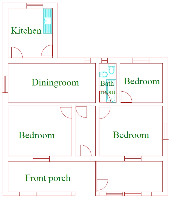

The layout looks like this at the moment: Three bedrooms, bathroom, kitchen, diningroom & front porch.
House layout
House layout

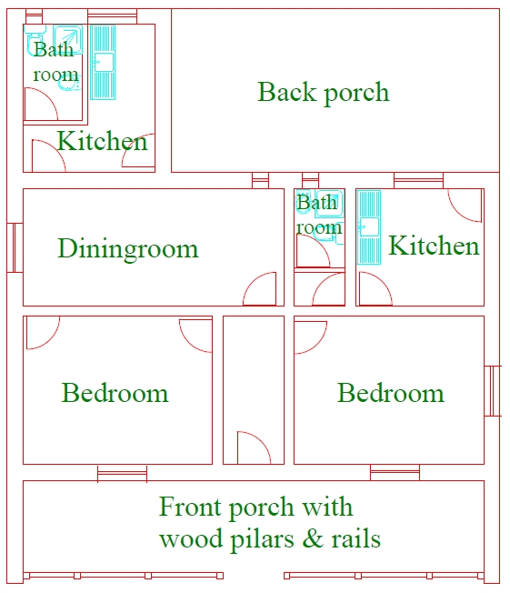

I want to divide it in two flats like this: Add a kitchen, bathroom and back porch.
Proposed
Proposed

I'm assuming the mid wall running left-right is load bearing for the roof and others can move, I'll leave layout to those better than me. I think it still needs work.

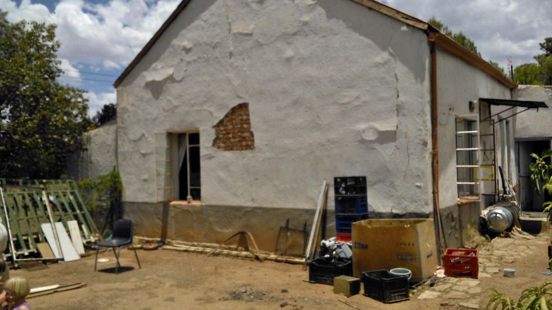

Frans
# Posted: 14 Dec 2015 01:20am - Edited by: Frans

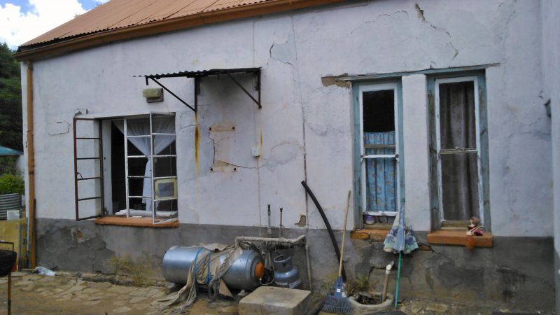

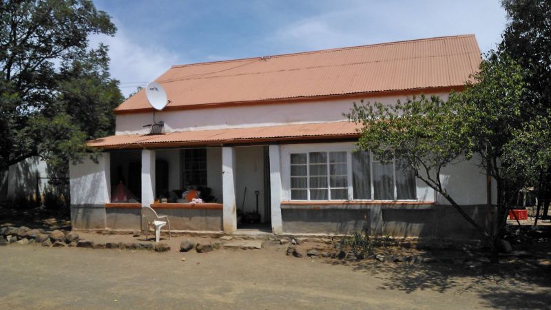

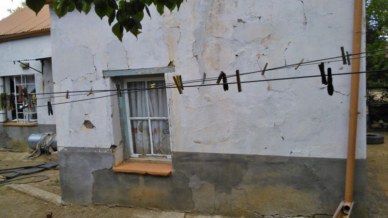

A few pictures. Sorry for all the garbage around. It belongs to the people living there.
Front porch
Front porch
East
East
North
North
Kitchen
Kitchen

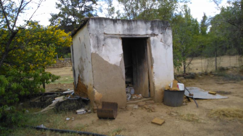

Frans
# Posted: 14 Dec 2015 01:28am

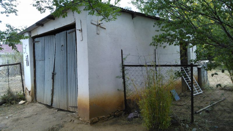

And I forgot about the barn and the long-drop toilet.
Barn
Barn
Long-drop
Long-drop

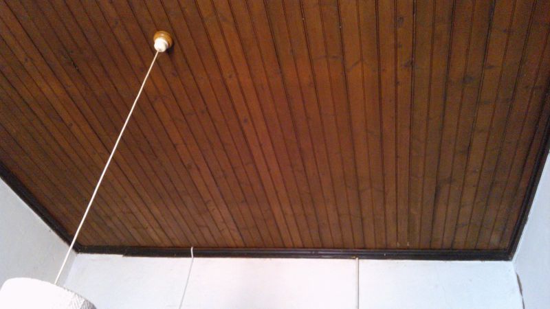

Ceilings
Ceilings
# Posted: 14 Dec 2015 08:48am
Thanks for posting Frans. We don't see brick construction much- at all- on this site. I hope you keep us posted on your progress.
My first thought is- why bother replacing an intact porch when you have so much other work to do? I don't think it's ugly but that's just me.

Don_P
# Posted: 14 Dec 2015 11:18pm - Edited by: Don_P
There's good restoration info here;
http://www.nps.gov/tps/how-to-preserve/briefs.htm
Long drop, that's a new name for me, dude, you have a brick ****house?
I did have on my builders hat describing how you could do a new front porch. My personal opinion is the porch and front view that's there is the charm of the building.
The propane would need to be moved off the future back porch. I don't like seeing a tank in a corner near windows anyway. The east end looks like a possibility and short run to the kitchen. That end looks like it needs the most TLC.

Yes, the porch is not really that bad. Problem is, they closed the right halve of the porch with windows and removed the pillars and one of the other pillars are also broken. I like the look in this post:

# Posted: 15 Dec 2015 01:48am
Quoting: Don_P
Yes, it is a family size brick $h!thouse. I will just fill it up and use it as a tool shed.

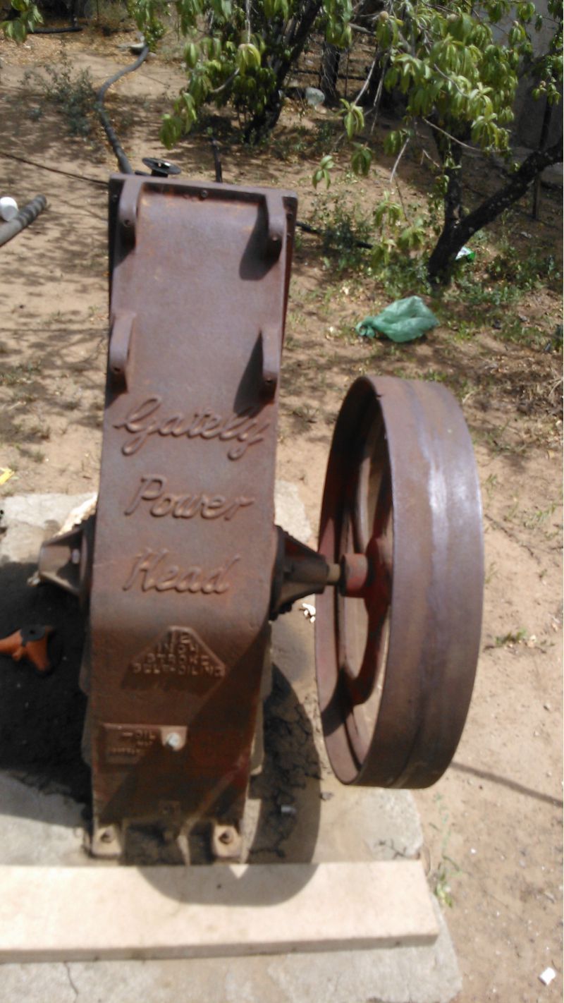

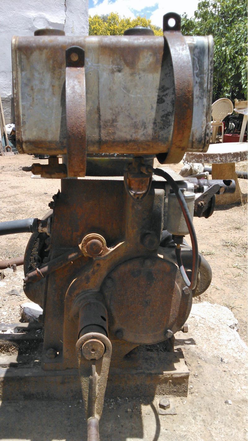

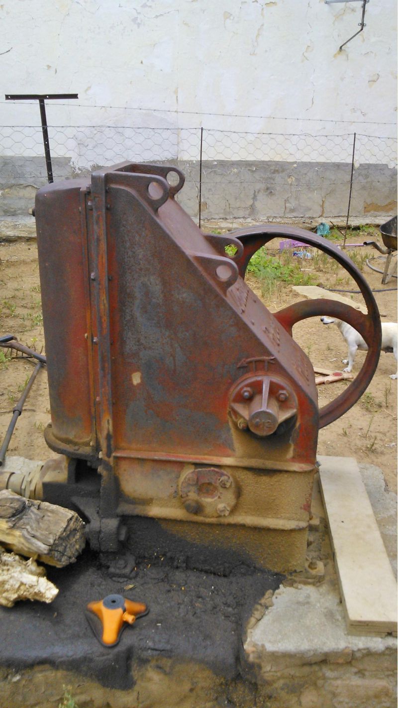

# Posted: 15 Dec 2015 02:13am
The old power head water pump on the well.
Gately power head pump
Pump
Pump
Wolsley engine
Wolsley engine
Don_P
# Posted: 15 Dec 2015 07:29am
I'm going to venture a guess on the term long drop. Up until the turn of the 20th century or so many rural homes, especially in our southern states, did not have any toilet facilities. People just wandered out behind the barn or the bush, often barefoot. The hookworm can only climb about 4 feet through the soil without finding a host before it dies. The pit privy was a sanitary solution as were shoes. This campaign was in full swing here during the depression years of the 1930's "No house should be without an outhouse". My aunts would still admonish us children "You younguns quit rolling around out there, you'll get the ground itch", which is the sensation left when a hookworm enters through the skin. Anyway, a guess that your public health people had a similar campaign.
# Posted: 15 Dec 2015 10:41pm
What is a Wolsley paraffin engine? Does it work? Cool.

# Posted: 16 Dec 2015 01:44am
Every farm had an outhouse. We only got an inside toilet in the 1970's. The towns had bucket systems. I think our town only switched to sewer in the 1970's.
The Wolsley is a British engine. This one is a Vesak which was assembled under lisence in South Africa. It was still running until the occupants fiddled with it and removed the cylinder head. Now it has no compression. You started it on petrol and when it is warmed up you switch it over to paraffin.

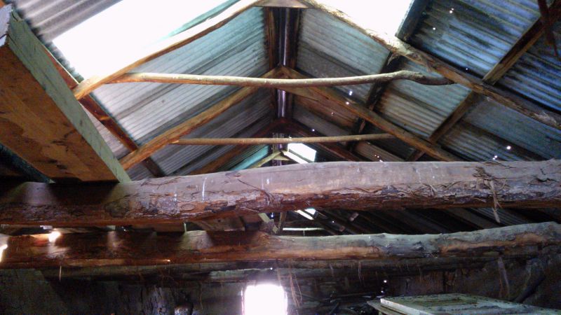

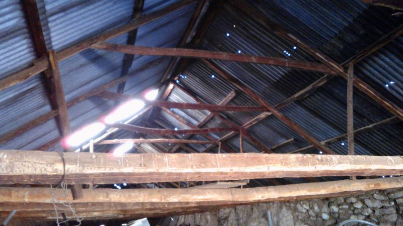

I took some pictures of the old barn on the farm with poplar wood roof structure built around 1925.

Another poplar structure
Don_P
# Posted: 17 Dec 2015 08:35am
That's a good use for the species, up high and dry. They went a tad long on their spans for the sizes which in that climate is probably not a snow collapse concern so just leads to the sagging. In the second pic they braced from the tie beams up to the rafters to try to prop the rafters at about midspan. A nice effort, it started being abandoned in the 1500's but the thinking persists.
There is a much better way, create a truss. Pinch a kingpost between the rafter tops, dangle it down and to the horizontal tie beam. The brits call that member a tie rod which I think is more descriptive. Visualize it as a cable, it can be, that is dangling from the rigid peak and cinching up the tie beam... which could also be a cable at midspan. That halves the tie span and provides a rigid non sagging point... from which to launch the props that support the rafters. These are compression members so need to be stout enough not to buckle while supporting about half of the rafter load.
# Posted: 17 Dec 2015 08:55am
90 years and still intact. Pretty amazing.

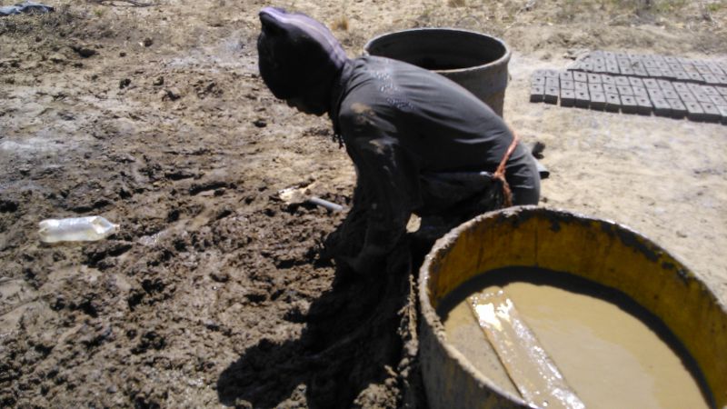

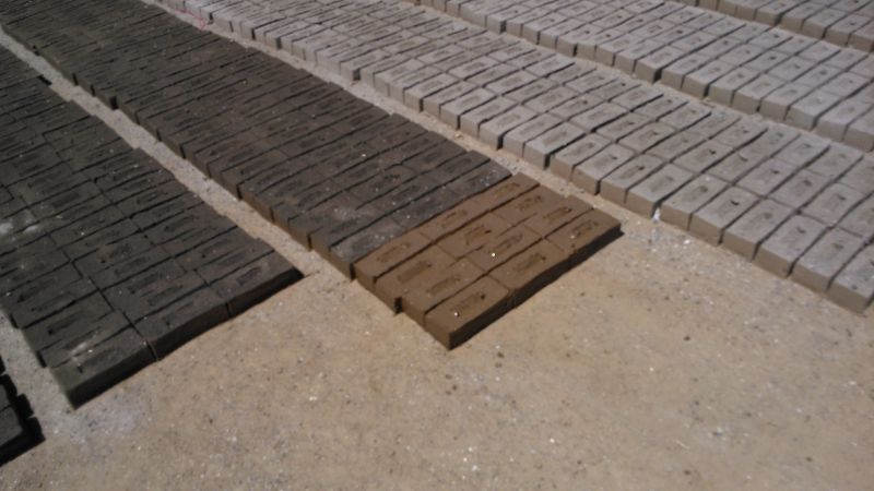

I found two brick makers from the Kingdom of Lesotho to make clay bricks on the farm. I can just admire them- they start working at five o' clock in the morning until seven in the evening. In the hot Africa sun at temperatures around 100° F.

Don_P
# Posted: 28 Dec 2015 08:15am - Edited by: Don_P
Very cool! Well, as long as they are doing those 14 hour hot days. Can you get some pics of their molds and of them making and molding the clay? Will they be fired or just air dried?
It has been over 100 years since brickmaking was a wheelbarrow trade in the states. Our buildings pretty much go to factory made bricks around the turn of the century. I did get to go to a firing of a large "clamp" of bricks several years ago, after air drying the bricks were stacked into their own kiln with internal passages to heat up the mass then fired with cords of wood, what an inferno.
Frans
# Posted: 29 Dec 2015 12:55am
I will take some pictures of them molding the clay.
Yes, we will burn them. They must make 30 000 for me. Then they will stack them in a scove kiln with coal dust in between and then burn them. It takes about a month for the kiln to burn out and cool down.

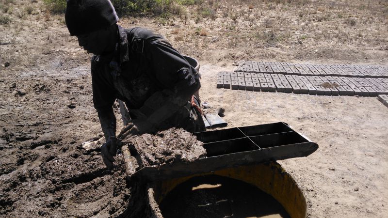

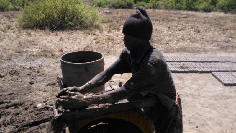

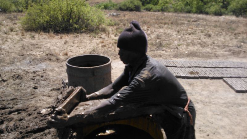

I got more pictures of the brick making.
Mixing the clay
Mixing the clay
Filling the mould
Filling the mould
Filling
Filling
Levelling
Levelling

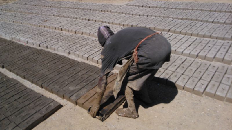

# Posted: 11 Jan 2016 01:33am

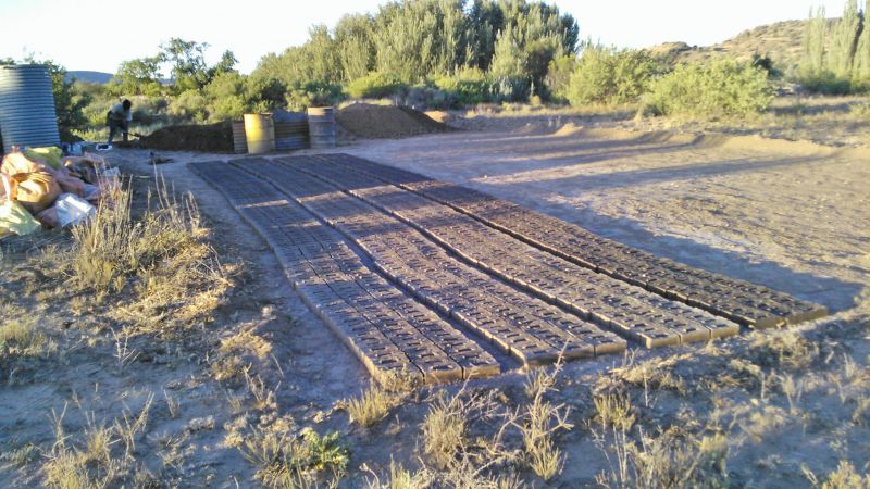

And then drying them.
"Casting"
"Casting"
Drying
Drying

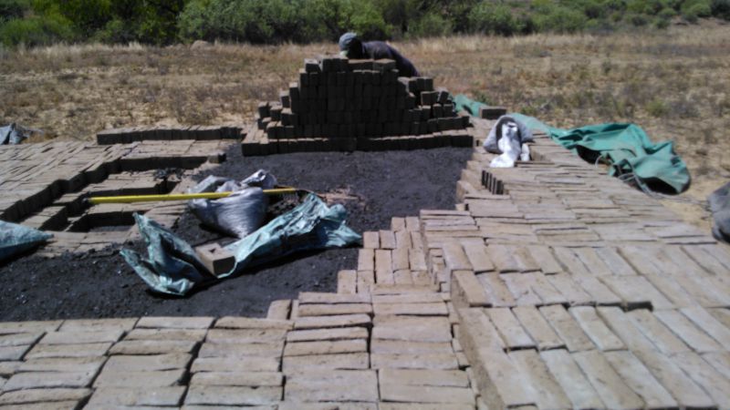

Stacking the kiln
Stacking the kiln
Frans
# Posted: 11 Jan 2016 01:37am
The two guys started on 21 December with site preparation and collecting clay. They started moulding bricks around 28 December. They went home on 8 January and they have made 14000 bricks already.

Very cool When do you think you'll be firing? And what do you fire with, is it all done with coal?

They must make at least 30000 bricks, so I believe we can start the fire by the end of the month. They are putting fine coal between the bricks, but they start the fire with wood.
