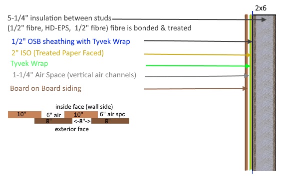

I went through a similar list of building types & doing research on them... We originally had been planning on Cordwood/Stackwall built on a Rubble Trench foundation as Cedar is pervasive here which is the best wood for such construction... Quickly realizing the amount of labour and complications we ran through a lot of variants.
In the end, if you've seen my Cabin Build thread, we went with a 24x20 FPSF Slab and stick build with 2x6 walls. Cost & ease to build (I'm familiar with stick build) plus less hassle... Although in my area Cordwood Building are popular and there are many from houses to massive barns.
We looked at "many" prebuilt sheds, cabins and found them lacking in various ways with one exception, a local Mennonite who builds amazing sheds/cabins with rough cut (his own mill) wood... $ to Lb good value and well built.
Then we found this: THE CANDLEWOOD BARN floor Space: 395 Sq. Ft. Loft Space: 315 Sq. Ft. which we really really liked... After buying the plans (cheap) we realized this would not work for us unfortunately... and I would have had to redraw the plans myself and submit it as Owner Designed & built (more flexible here in that regards). This type of structure could lend itself to Smartwall / Perfectwall methods quite easily. One attractive feather is the 4' span between the 4x6 studs (plans variations).
Here is a GOOD Blog by a fellow who built one of these Candlewood Barns, worth a perusal ! tomsgardens building-my-small-barn
There is a building around the corner from me, identical to these Allwood kits but that one is produced in New Brunswick, Canada. Looks nice and Maggie always mumbles when she sees it (wants one as a Bunkie / office). We have been in it and looked very closely at the method and I like it BUT - There it is... Insulating it (must have here) would be tricky and would most likely be best with exterior rigid foam like XPS or ISO but then you'd also have to float siding over that which would detract from the exterior. OF NOTE on Water Penetration !!! The building here has water stains in each corner as the wood catches the rain and allows wicking... even though there is a thin gasket between the "logs" and both sides of the wood is clear stained & finished.
Off Gassing: Foams like XPS & ISO don't offgas, neither does Rockwool (Roxul). Soy based spray foams only offgas while curing (< 48 hrs in summer) and for the Urethanes, well, they off-gas a while . I myself am quite sensitive to chemical exposures so that was a primary concern for me as well... I'm using ISO for my cathedral ceiling & the 2" exterior clad and EPS-II with bonded fibre on each side between the studs internally. See attached diagram of how I am assembling my wall structure.
I hope it helps and doesn't muddy the waters more... Sometimes too much info and opinions can become Overload.
