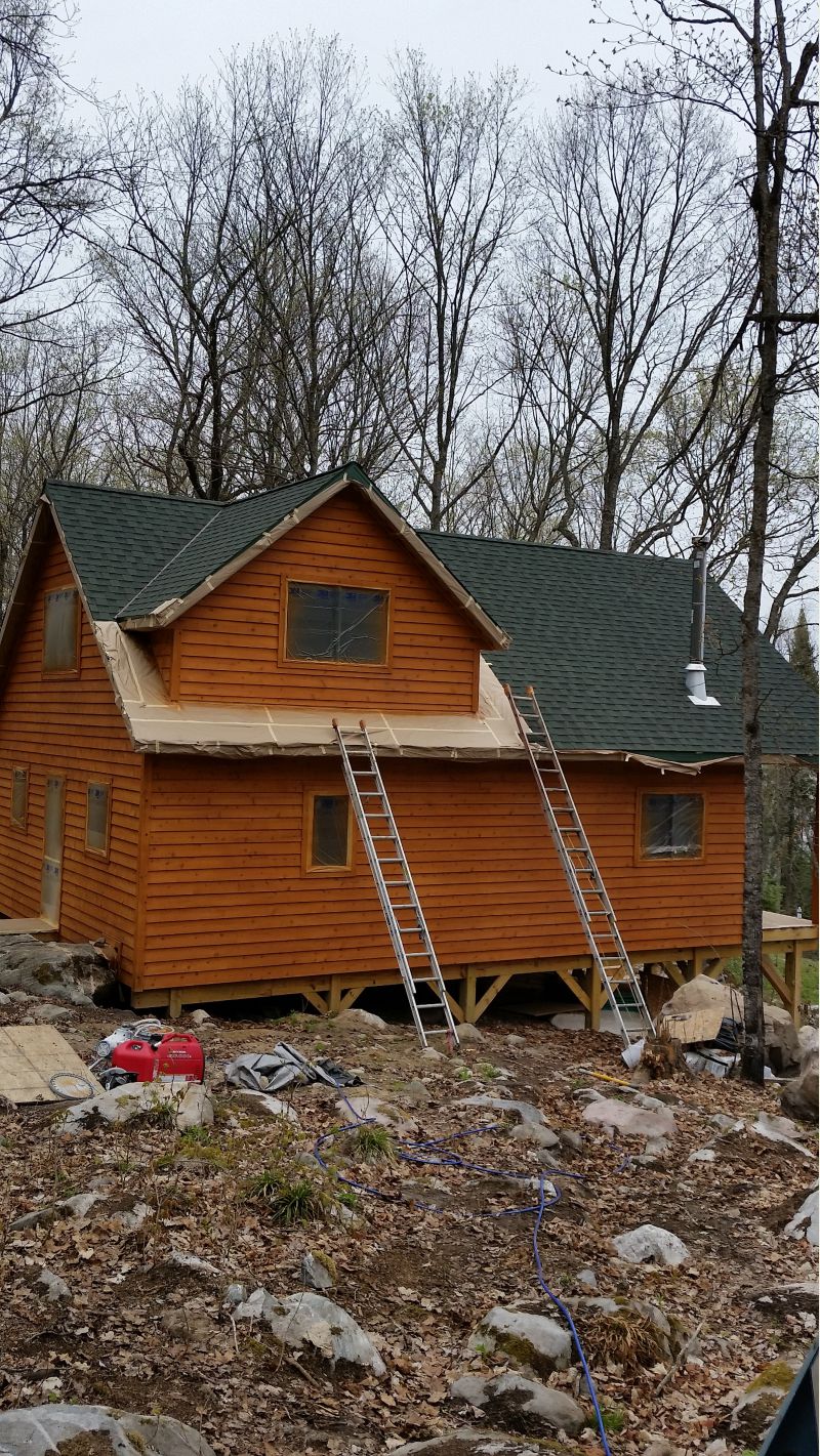

gsreimers
# Posted: 7 Jan 2016 05:08pm
  For what it's worth, I sold paint for 22 years and have been a painting contractor for 8.  When it came time to stain my cabin I went water based product.  (woodscapes semi transparent stain from Sherwin Williams)  Water based products aren't quite as warm looking as oil but seem to last longer.
gsreimers
# Posted: 7 Jan 2016 05:10pm
  2 coats, sprayed and back brushed
gsreimers
# Posted: 7 Jan 2016 05:25pm
  sorry, took a while to resize the photo
# Posted: 7 Jan 2016 06:05pm
  @gsreimers,   That is a really nice colour !
  How long has that been out there in the weather ?
  Have you noticed differences between the sunny & shady sides as to colour and finish ?
gsreimers
# Posted: 7 Jan 2016 06:30pm
  Steve,
  unfortunately, I can't give you a good report yet on life as we just did it this spring.  Solid color products last longer than Semi transparent.  Solids will eventually peel whereas semis kind of just fade away.  If I can get 5 years before I have to wash and recoat, I'll be happy with it.
  I do have an advantage though.  When it comes time to restain, I have a group of employees that will help me with it.
