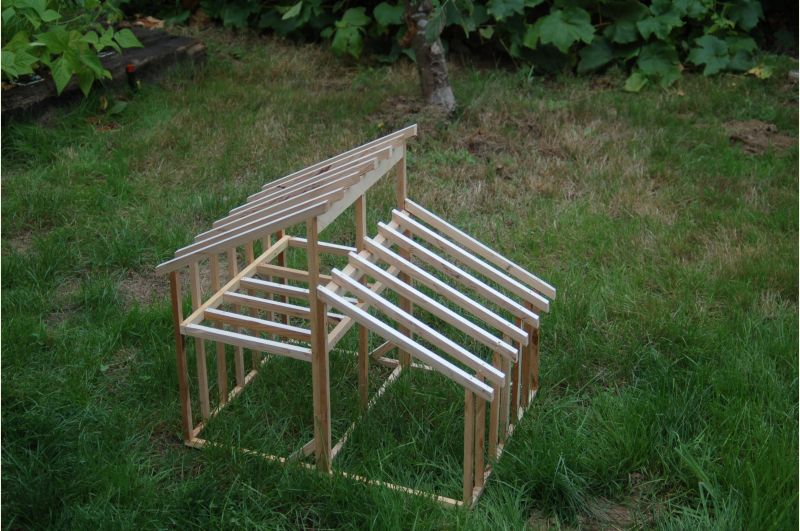

That Mackenzie design is somewhat the way I'm going (simple leanto) but building two (short one first) and putting them together.

If allowed you could build several 10x10 structures and stay under the code requirements. The only drawback I can see is that it could be hard to heat several separate structures. Advantages are that you don't have to permit and you can easily add living space without having to get one large structure dried-in in one season.
Swamp Thing
A 10x10 is a bit small but with a loft up top and a futon couch down below you would still have room for a small kitchen spot and a little storage.
We just finished a 10x12 and it works quite well.
