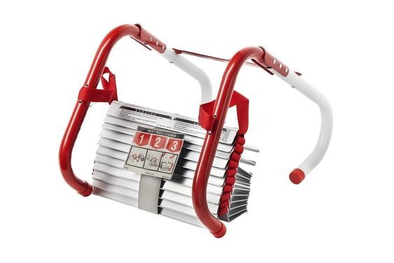

  We sleep in our loft. Have two windows up there on opposite ends for good cross ventilation. We also have two fire escape ladders. If you are going to sleep in a two story house I would suggest purchasing one.

  silverwaterlady Where can you buy those ladders at a good price?
# Posted: 27 Jan 2016 12:23am
  I bought mine on clearance at Walmart.
Julie2Oregon
# Posted: 27 Jan 2016 01:06am
  Wow, I never thought Wally would sell something like that! I'll have to check it out. Thanks!
