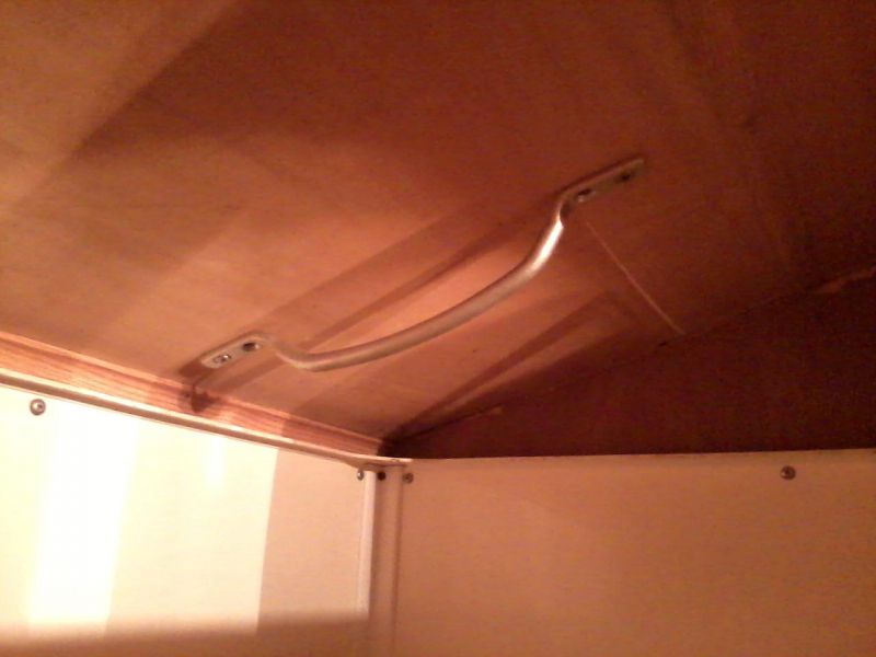

We have the same unit and it has worked out well for us. I added a grab bar on the ceiling, but you could also put it on the side walls.

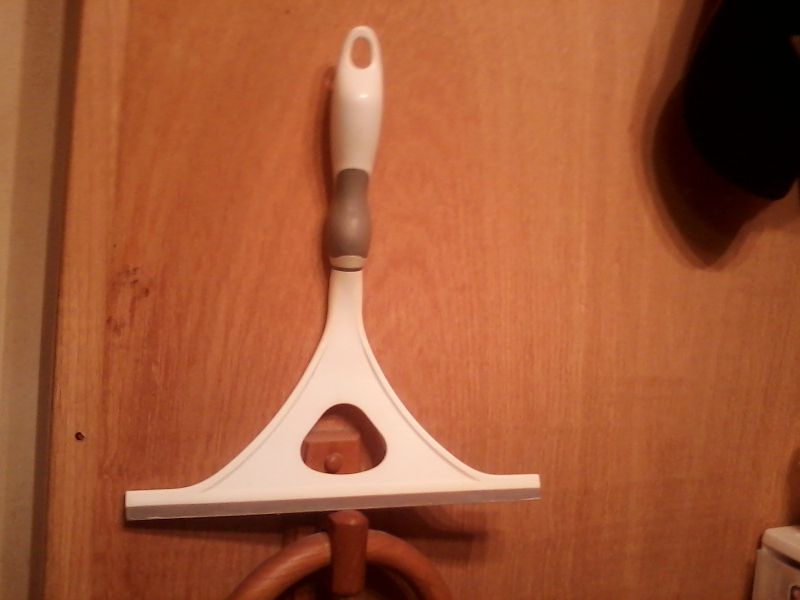

To help with keeping the stall easy to clean, we got a squeegee that we use after taking a shower. It only takes a few seconds to squeegee down the walls to remove the soap scum etc.

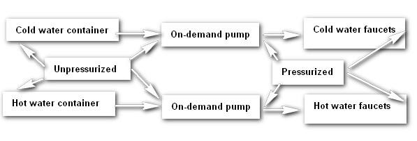

Here's where my concept differs—I'm trying to avoid incorporating a hot water heater in my water system. I mentioned why in a thread I hijacked three or four months ago, but I'll explain again. I've been a weekender for a couple of years now and I've learned my hot water (I refer to it as hot water, but really it's warm water, and below the on-demand water pump's high temperature specs) needs are minimal--a couple of gallons for a navy shower or to wash dishes, and that's it for the day. Depending on the time of day, I could see how a pot of water heated on a stove in the morning or a container left in the sun all day would satisfy my hot water needs. (I've also got a turkey fryer I can repurpose as an on-demand hot water heater for the rare times my wife comes with me and demands hot water).
Ideally, I'd like a system where an on-demand pump would pull cold water at any time, but would also allow me to pour a couple of gallons of warm water into some sort of container (maybe under the sink) to mix with the cold water as needed for those one or two times a day I want hot water. I don't want to have to pressurize that hot water container. The only way I see to do this is to have a separate on-demand pump for the hot water side, something like the diagram below. I just wonder if I'm missing something and there's some way to run both the cold and hot water through the same pump, rather than using two.
