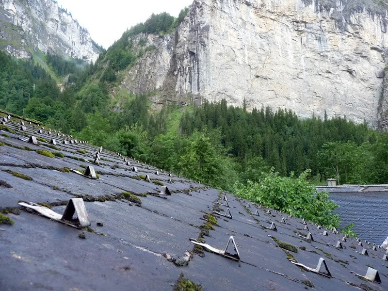

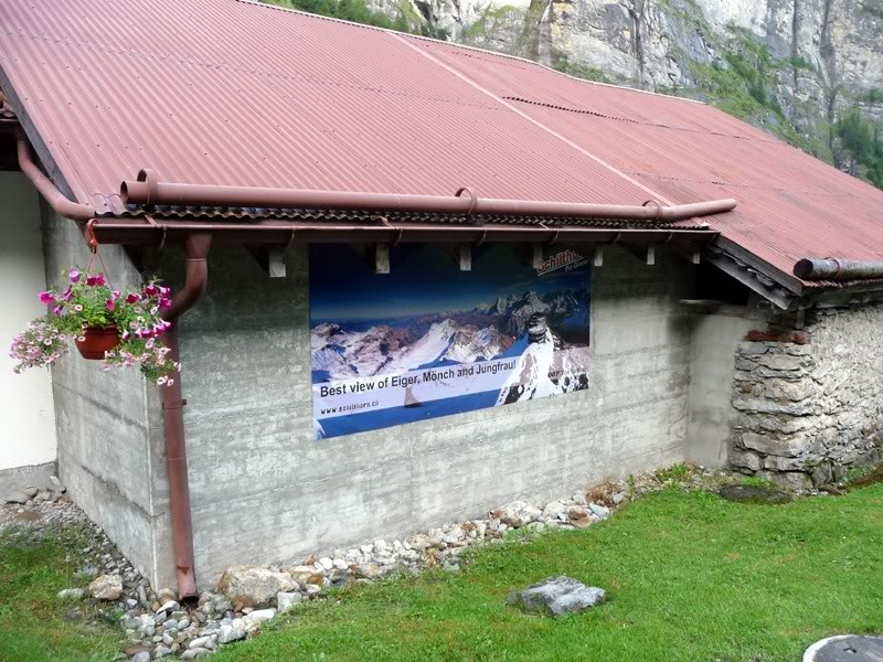

Regarding snow. If the roof structure is built to withstand the expected snow loads gutters can be installed for saving water as long as devices are installed to keep the snow from sliding off. This has been done in Switzerland and Austria for years/centuries.
The more elegant solution is to use "snow birds". Many rural locations I've seen over there use a more utilitarian method. Pipes are mounted just above the roof surface near the eve, parallel to the eve. They keep the snow on the roof. And they do get a lot of snow there.
The roof shown with snow birds is slate, just about as slippery as metal. "snow birds"
|  the old pipe solution

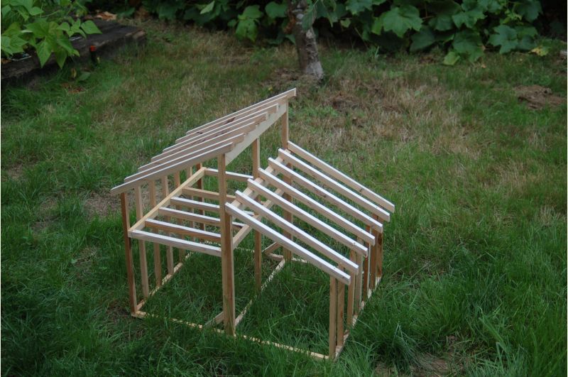

# Posted: 6 Nov 2010 08:58am
Yeah, I hear that. However, I plan to use 2x6 T&G or car decking for initial roofing. Hope the photo shows that well enough.
BTW, great build Nathan.
