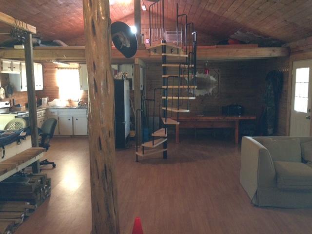

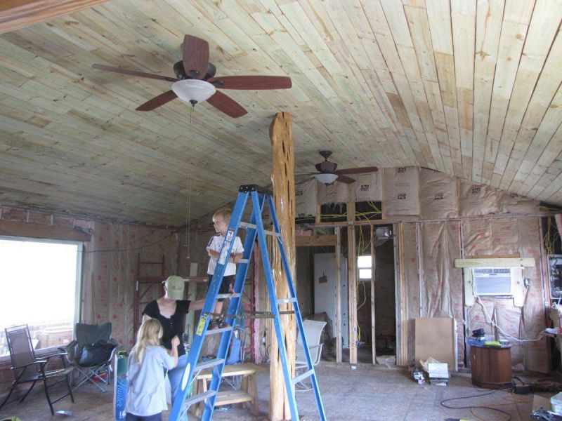

  We wanted tongue and groove for the inside of our cabin but could not afford it so bought 4 pallets of new fence wood and stained it (would have taken WAY too long to get all the used wood).
  Turned out good, imo.
# Posted: 17 Oct 2016 05:30pm
  @jrbarnard...   Looks pretty good IMO, I am curious what you have behind the planks ?    Straight onto studs / vapour barrier or over something else ?    Any problems with spaces opening up at all (humidity expansion & contraction) ?
jrbarnard
# Posted: 17 Oct 2016 07:23pm
  Here's a picture for reference. All we did was studs and insulation. We added solar board and tar paper under the metal roof.
  The key was to stagger every board and we had to measure every single board.. heh
  R
# Posted: 17 Oct 2016 07:52pm
  Thanks for the speedy response & pic ...  I bet there was a grumble or two with all the fiddly bits ;) worth it all in the end though.
