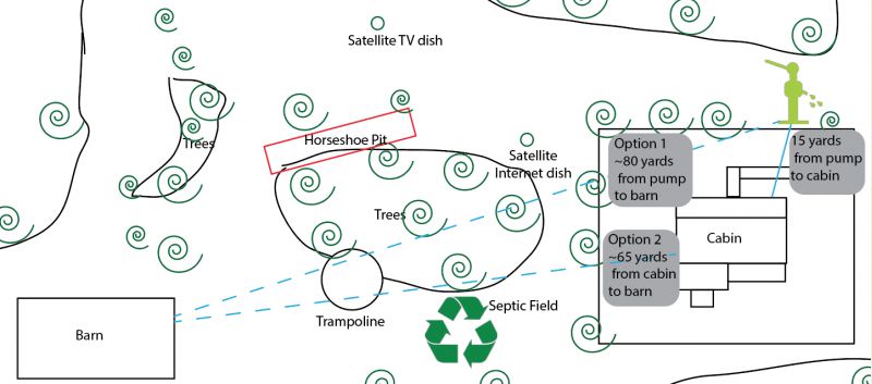

  I have a cabin with a well water system.  I have a barn that I'm going to add in a workshop, game cleaning station, etc.  However the barn is a good distance from the cabin so porting water to it manually gets old real fast.  I want to install a faucet in the barn, and I'm considering a couple options:
  1) tap into existing well that feeds cabin and run a line straight to the barn  2) tap into water from cabin and run a line to the barn 3) dig a new well closer to the cabin
  Besides cost differences of running a line vs digging a well, here are some of the disadvantages of each option. 1) can you put 2 pumps into 1 well? 2) though it will tap into the water that has been softened and aerated, not sure if that is necessary for cleaning my ATVs, processing game (ie venison), or washing oil spills off the barn floor.  Also, going from cabin to the barn goes very close to the septic field. 3) not sure if there is a good spot close to the barn.
  Another point that affects options 1 and 3.  The ground water does have a lot of iron, so taking the filtered water from the cabin may not be a bad idea for cleaning game meat as I'm processing it in the barn.

  Run the line from the pump to the barn , no problem running by the septic as  long it is a positive pressure line, not a suction line ,

  I would ask if its level, the pressure wouldn't be much of an issue. If it was mean, I'd run water to the barn. Where you tap into the existing system would be up to you. Run a 1" line tapped into a 1" line (feed tot eh cabin now from well), use the black poly pipe.
  That is what I would do.

  RedTail Hawk      Couple quick question , what kind of pump system do you have. Is it a single line submersiable or twin line jet pump, is the pressure tank in the cabin or in a well house over well. Depending on how your system is set up will determine where you hook line in for barn , maybe you dont have either of these set ups.  If there is a pressure tank involved then you should hook in after the pressure tank and head to the barn.    Littlecooner is right on installing like he explained, just make sure you use stainless steel clamps with stainless steel screws.

  Coonner you are correct each tank doesnt need electric. On most systems the pressure tank, pressure switch, control box ,check valve and electric are in the same spot, like they are on your system in your well house. Every pressure tank you add after the check valve is just adding more capacity to the system. Until we  have more info on hawks system we are all guessing on what would be the best hookup. Looking at his drawing  the well is close to the cabin so Iam assuming that all the components to the system are in the cabin to help keep them from freezing. Some one said tap into line from well to cabin and run to barn, if you do this and the check valve  is in the cabin you would only have water at the barn when pump is running. If you install a pressure tank at barn you would need electric to run another set of controls, unless that tank is hooked into system after the check valve. I hope this makes sense.
  Hawk the easiest and cheapest is to run a line from cabin to barn and install a hydrant at barn. You will have all the pressure you need for what you say your using the water for.

  Thanks for all the great recommendations.  I think I'm going with the line from the cabin, connected between the pressure tank and the water treatment system in the cabin.  I'll put an underground tank at the barn with a hydrant valve so that water cuts off underground down below the frost line.

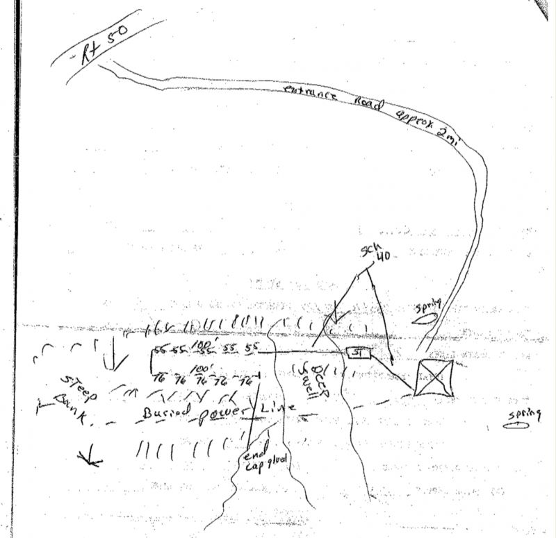

  Now here's another question. The septic system was installed in early 1990. When I bought the place, the guy didn't know where the septic was exactly, but said his dad had drawn a diagram when he filed with the county. I did a little research and got a copy of that diagram. (Note: I'm pretty certain this diagram wouldn't be accepted at any county government today). Not only is it not to scale by any means, but the orientation of certain objects on the diagram don't seem right. Anyway, does anyone know how to read the numbers that are sketched around the area that seems to be the septic field? I'm assuming the box with ST written in it denotes the Septic Tank.

  ST does stand for Septic Tank.  They used schedule 40 pvc for the plumbing from the house to the field lines.  If you need to find the septic tank, there are always wire "handles" on the lid for lifting in place and most have wire or some from of steel reinforcing in the lid.  a normal 1000 tank is rough sized as 5x10.  Any metal detector should pick up the steel in the lid so you know exactly where it is located.  Remember, everything has to flow on a slight grade  and the field lines are always level.  So they put in 200 feet of absorption field, ran the header straight from the outfall of the tank to the beginning of the first 100 feet of field lines, then did a crossover at the end, so the second run of 100 feet of line will be total level but could be at a lower elevation that the first.  normal minimum separation in my part of the world is 8 feet, so i would expect similar there, let us say 10 foot between two parallel lines for discussion.  I would think that those numbers are depth to the bottom of the trench. That is a guess, but I can not see any other reason for these numbers.  Hey, it is an "as built" and may not look great to the eyes, but could be what your local officials would even accept today. It is all about the value of the location and data, not about the eye appeal. Note they sketched the septic tank in line with the front of the house and also showed a buried cable "towards the back".  Most of the time, a slight depression where buried cable has been installed can be detected, due to mother natures compression of the disturbed soil, especially if it was opened with a back hoe (wider trench) over using a trencher.  Does the lay of the land at you site make it reasonable that those numbers are depth to trench, because it is level on 100 foot run?
  Those little arrows pointing "down" indicate flow of surface water and it appears that the lower line at the greatest distance from the house is only 16 inch deep for a few feet, which could be why they placed the remainder of the line at such a deep depth of 76 inches.  A tape and little work on the ground to see if the slope drops off at some 120-130 feet from the bottom of the swale would lead one to believe he has a nice idea of where these lines are installed.

  thanks for the all the great info Littlecooner.  I have a general idea of where the Septic system is because of the clearing towards the side of the cabin.  The hand drawn diagram makes it seem like it is in the stand of trees, which I don't think would be over a system.  I may try to rent a metal detector when the snow is melted.
