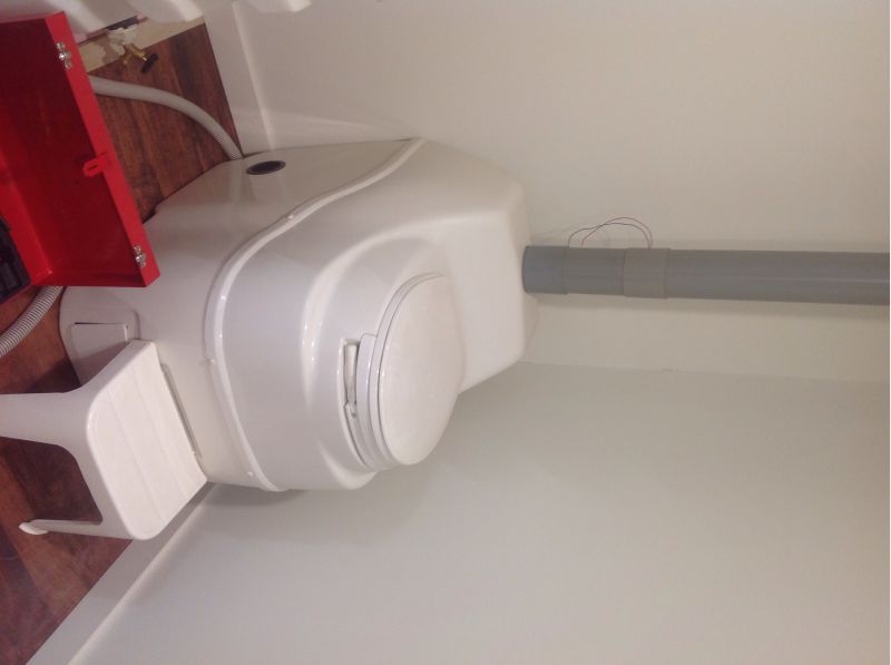

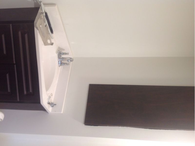

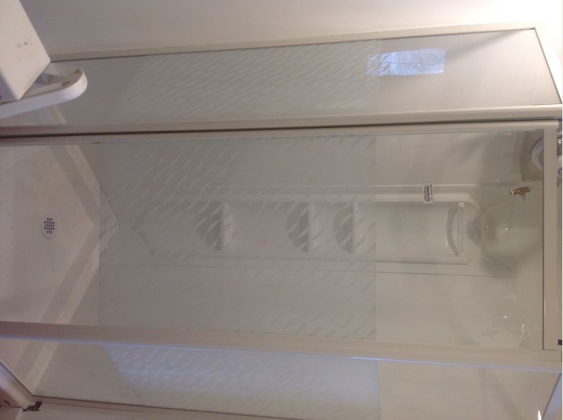

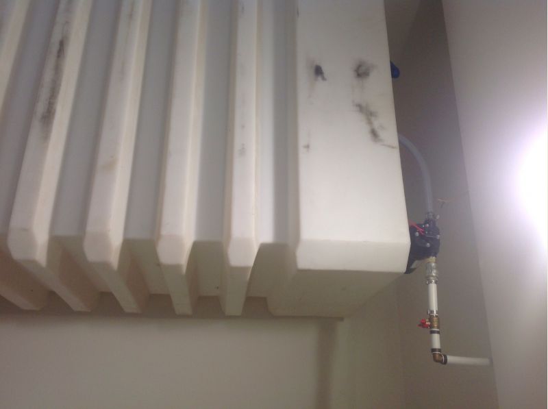

Coyote Flats
# Posted: 18 Feb 2016 04:24pm
  Hi Alex I just back up my truck to my front door and pump water into tank using a garden house and small Honda gas pump. If your tank is in a building outside with your pump than you will likely need a insulated pipe into your cabin but you would need heat in your storage building if you intend to use it in the winter. I made sure I installed low point drains on the sinks, shower , and on demand heater. Water is my biggest expense but not to bad as it's about 4 km away. I also haul water for garden and greenhouse but that water is just over a km away. Water is free just fuel for truck and pump. The bathroom is 8 x 10 and has little wasted area.  image.jpg

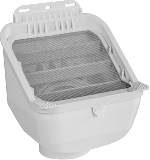

Steve961
# Posted: 1 Mar 2016 11:45am
  This is what I use to pre-filter the rainwater coming off my roof.  It seems to work well and only costs $29.95.
  Leaf Eater Advanced Downspout Filter
