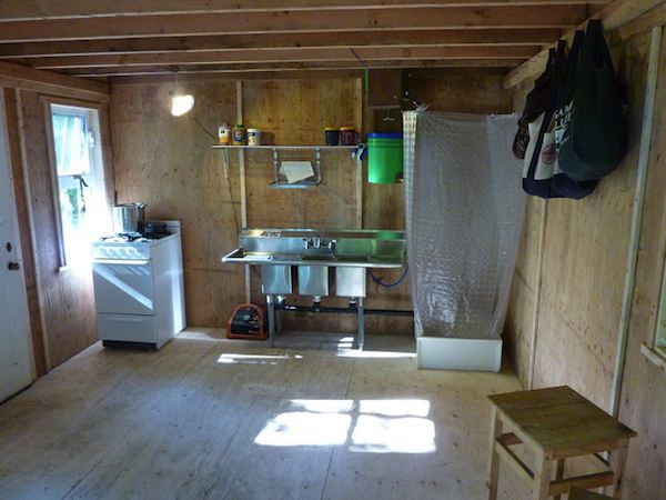

Could you build a 10x20 and make the porch a separate 10x10 deck with sloped roof? Might be more comfortable.
Here is a picture of a shower box with shower curtain in a tiny cabin.
Are you planning on having a woodstove?
