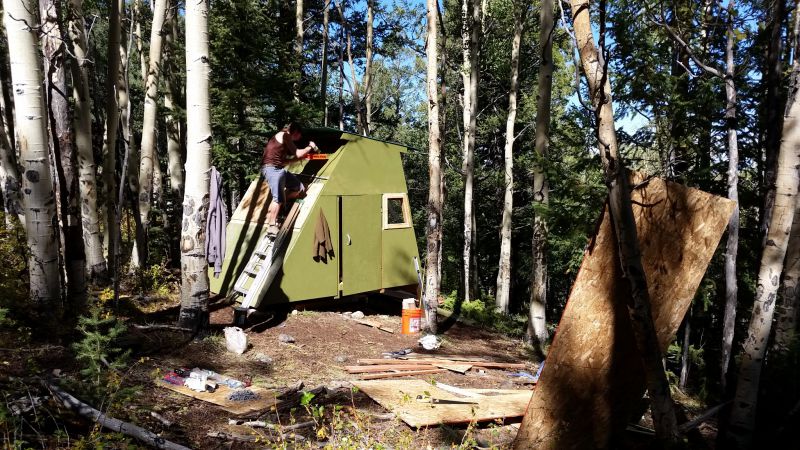

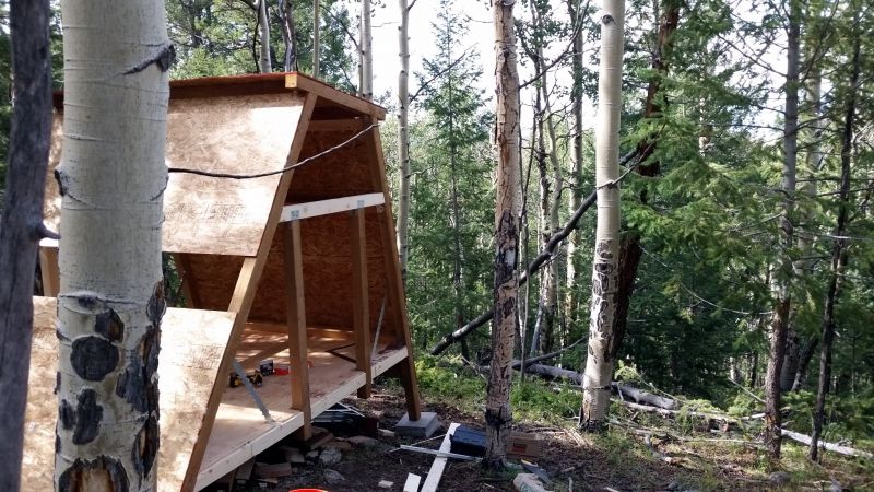

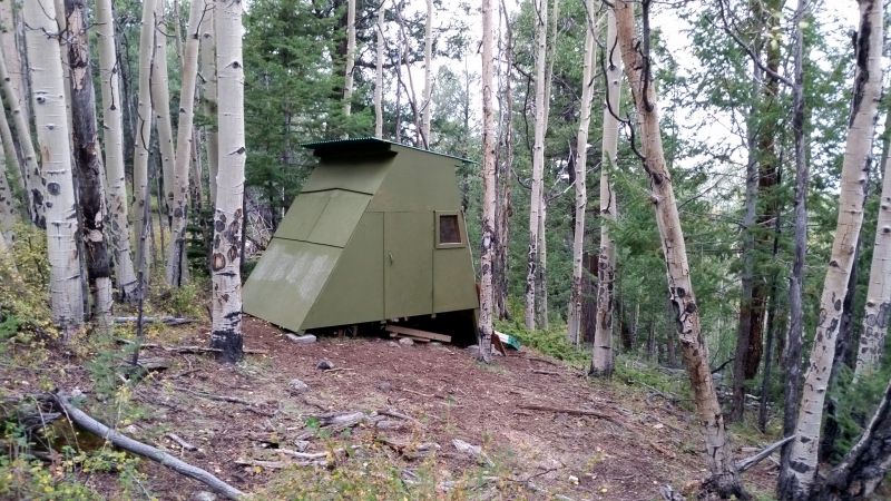

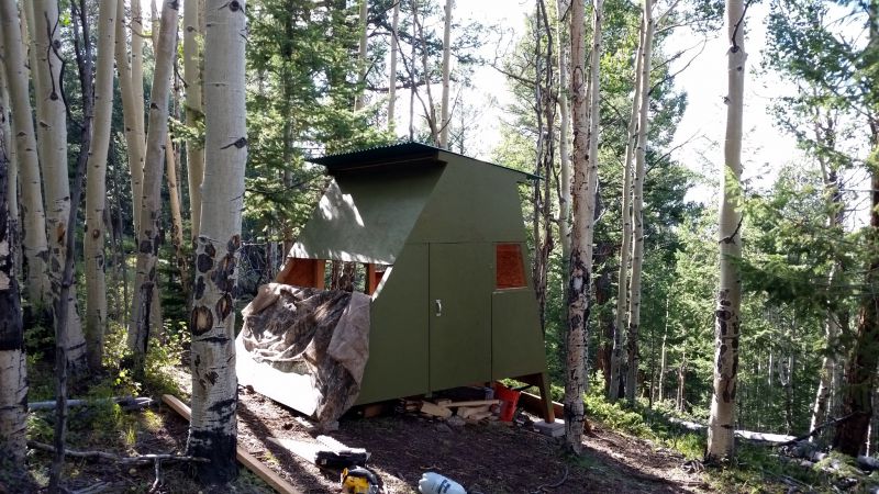

I built a 10'X10' hunting/photo blind 2 years ago and thought some of you may be interested in seeing my non-traditional building "style' on this project.
The reason for the non-traditional build was the steeply sloping lot that I own that also has limited access. I did a good deal of the project on my own so I had to come up with a design that would satisfy my needs while being practical to build solo. This property is generally not accessible during the coldest and snowiest months of the year due to drifting so my use was limited summer camping and hunting/photography blind. This piece of property is 10 acres of North facing slope, heavily treed in aspen and spruce and sits at 9800' altitude. There is a small ledge, possibly from a old logging road, that transects the property. It is too heavily wooded now to use as an access point but was the perfect place for my shelter. I had to hand carry everything downhill about 100 vertical feet over 200 yards of trail.
Since the nearest power line is over 12 miles away everything was done by hand, except the plywood cuts, which were done with a DeWalt battery powered circular saw and drill.
There are a million things I would have done differently had I found this website before starting my build, this is what I came up with on my own.

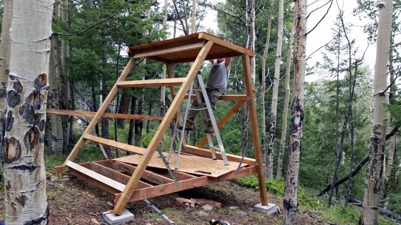

my buddy helping on the roof

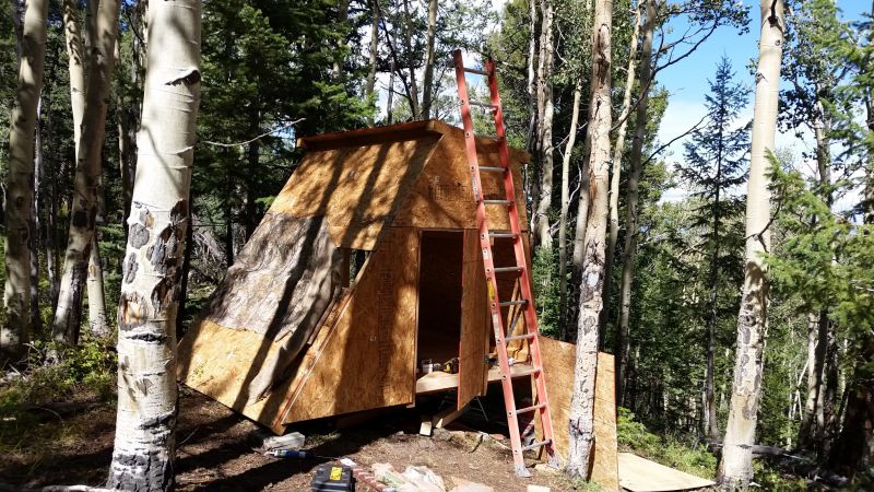

Starting the siding
Starting the siding

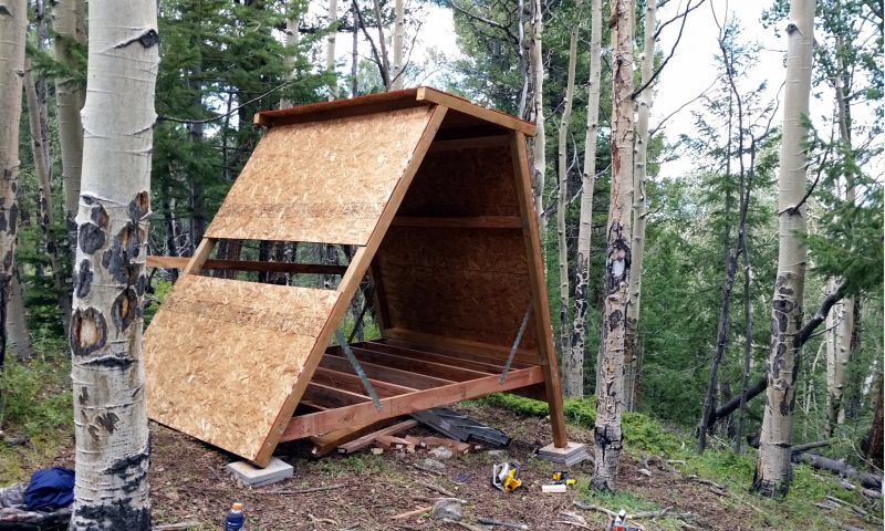

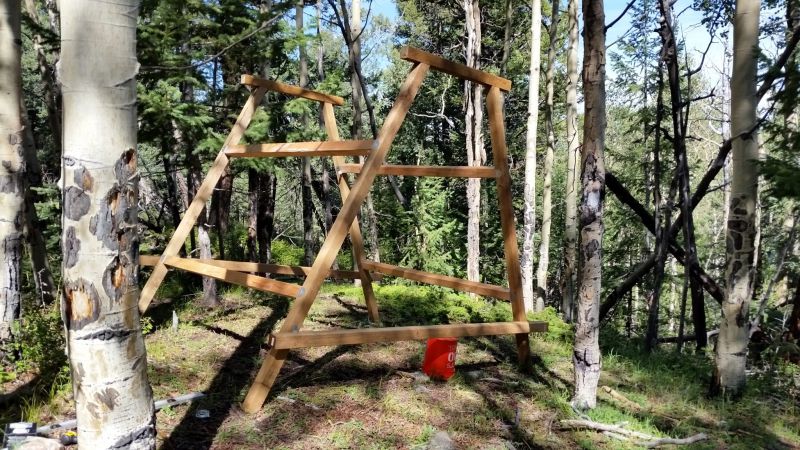

I built the A Frames at home in my flat driveway so they would be straight, then took them back apart for the 1.5 hr drive to the property, then moved everything down the hill and re-assemble it. Standing both sides of the frames up and adding the lateral supports, by myself, was a royal pain.

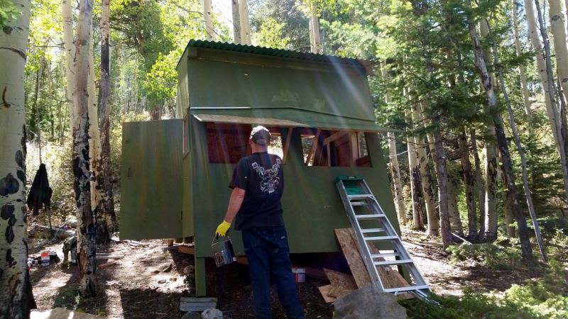

Starting the paint
Starting the paint

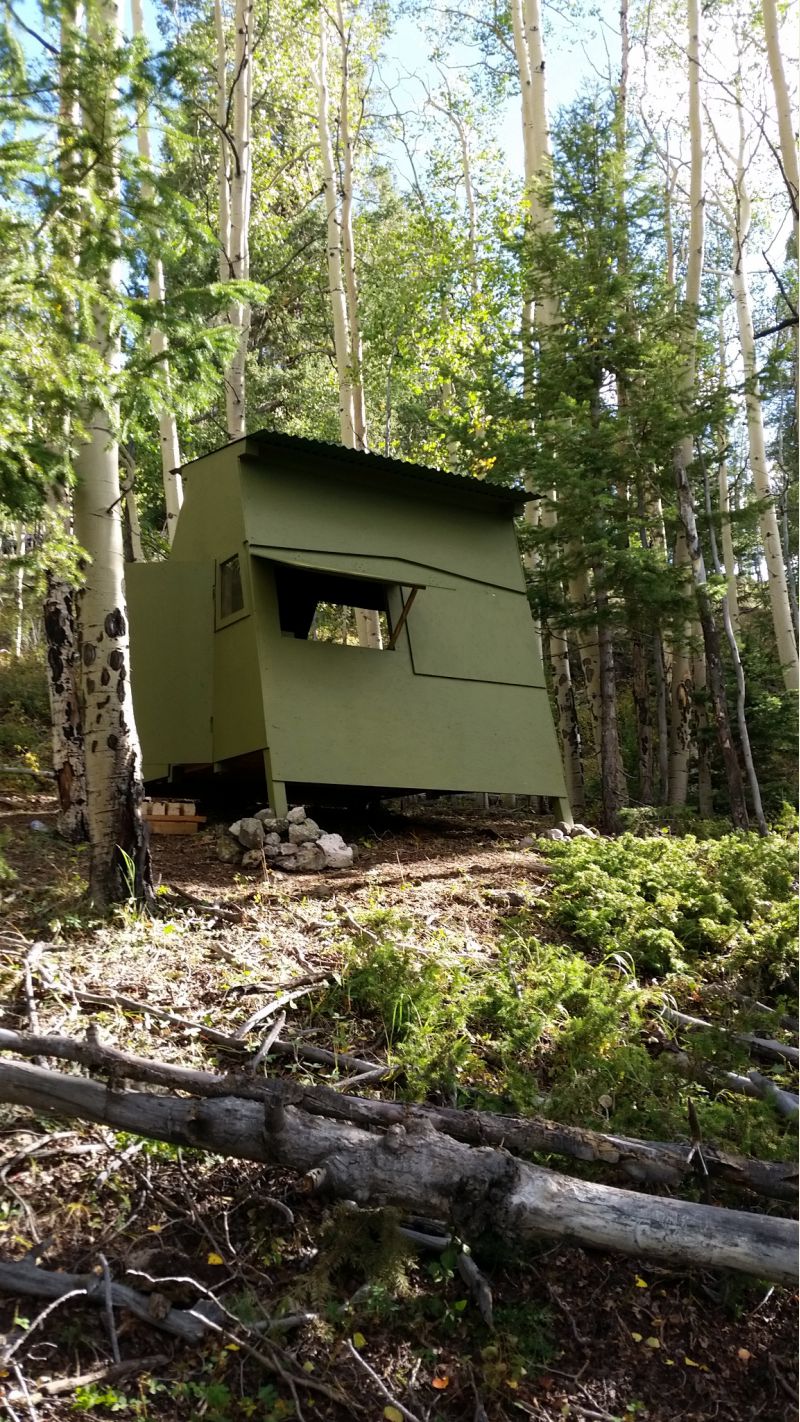

Finally dried in
Finally dried in

very nice set up....I really like the look!!! Any particular reason for the A frame look?? just asking!!!

Thanks TH, I thought if I could make the A frames, and square them up with the cross braces on site, then I could turn the whole thing perpendicular to the hill to give the roof some slope and make the cross braces level across the hill. Then I could hang the floor joist in level no matter the angle of the A frame. It was the easiest way I could think of to get a level floor without a foundation. I also wanted to be able to stand up straight to stretch so that influenced the taller A frame as well. It ended up having 6'6" inside height after hanging the floor.
If I had it to do again I would have built on stilts as you describe with traditional stud walls. Mostly to get the siding up out of the snow pack and I worry about the 4X4 legs of the A frame warping over time from the angle. I did have fun building this though, just making it up as I went

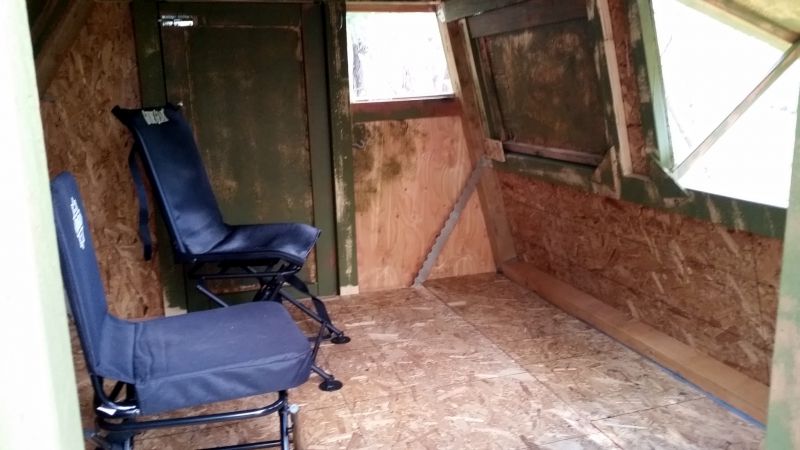

luxury seating
luxury seating
