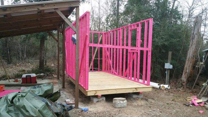

  I am building a 8x16 shed style with studs 16" on center.  I wanted to use cedar pickets (got a great deal on them) for the interior walls.  Being I am 16" on center and the pickets are 6', there is a dilemma I need help with.
  Should I
  1) cut the pickets as needed to align with studs (horizontal pattern) so I can nail into studs and the ends of pickets are not freefloating and cause warping issues later?  This would basically be cutting 2 foot off each board, but I have plenty if this is the best route.
  2) install 1/4" plywood to studs and then brad nail the pickets to that?  Only hesitation with this is weight.  I built this cabin with a stipulation that it has to be mobile in the event we need to move it in the future.  However, if this is the best solution for the walls, so be it.
  3) something else?
  If it matters, I will have 2 in of spray foam behind the pickets, then 1/2" plywood, then Tyvek wrap, metal exterior walls.

  You could go on a diagonal ,spanning 5 studs , not sure of the exact angle but what ever works .
