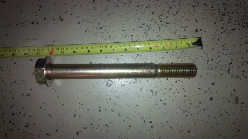

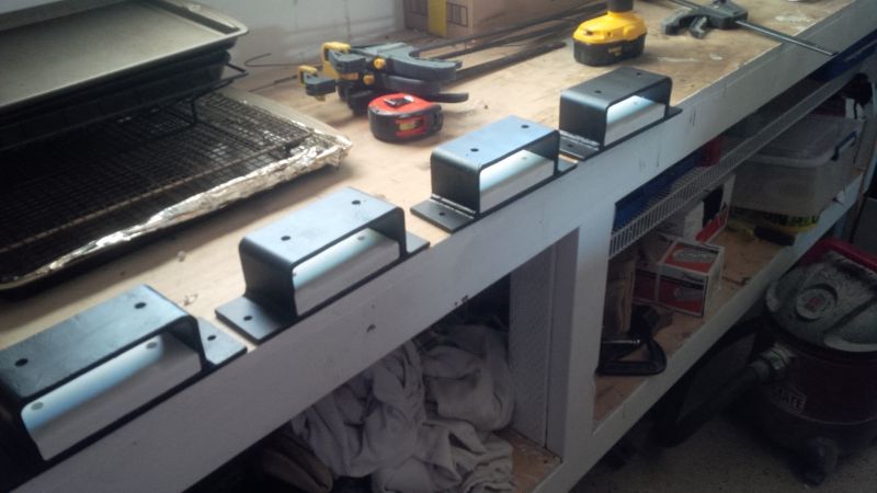

Haltzy
# Posted: 15 Mar 2016 06:22pm - Edited by: Haltzy
I built these myself. Will be using them to support 2 16' 4x12 beams.
All I can say is make sure you account for tree sway and tree growth.
I'm getting mine up this year as well. Good luck and have fun.
Haltzy
1 1/4 Tab
1 1/4 Tab
Beam Brackets
Beam Brackets
