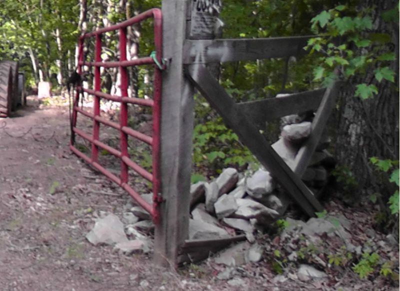

One thing I have plenty of in West Virginia is rocks. I plan on making some stone walls around the property entrance using slip forms. But I was thinking about maybe building the cabin with stone walls since the material is free, except bags of mortar. Are there types of rock to avoid?

Generally if the rock rings rather than thuds it is sufficient. From what I see maybe blue dolomitic limestone? An acid will fizz on limestone. On a few projects, rather than a true slipform, I've formed just the hidden backside of the wall. Mix mortar and concrete and lay the face stones with mortar then shovel in generous pea gravel concrete and quickly laid fill stone back to the form. A "rubblestone" wall should be a minimum of 16" thick.

I'm no expert but from what I have found on the net I think it is gray sandstone. I need to grab a piece and take it to an expert.
Don_P, like vinegar?

I use muriatic... dilute hydrochloric acid. Battery acid would be strong enough to show. I'm not sure if vinegar is strong enough to fizz but worth a try. Sandstone will not fizz... and it has sure fooled me into thinking it was limestone or one of the calcerous rocks before.
