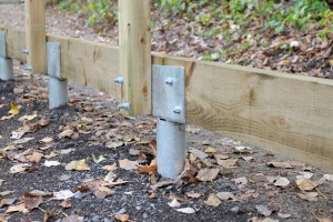

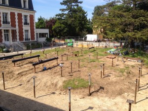

Those posts look pretty cool. How much were they installed? I'm in central texas and "extreme" frost penetration would be about 5" max. Most years it is very little. Maybe an inch.
I've got a tractor with a pretty robust box blade and can cut channels pretty easily. Below frost depth would be cake.
I'm trying to keep this as inexpensive as possible but I don't want the building shifting around. In looking around at the helicals, they seem to be $300 per coil or more. On a 16x36, I'm guessing 18 or so "piers" which would set me back $5400. I got a quote for less than that for a full slab. With a good gravel and soil prep and keeping the perimeter watered so it doesn't swell/dry, I'd probably be fine.

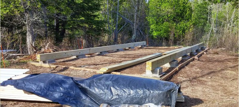

I built a 16x32 Cabin on two rows of pads. 6 feet apart. The frame rest on two large skids. I followed Owen Christensen on this forum who has a lot of experience building on skids but I bet 36 feet long would be pushing it...My cabin has not moved yet though I'm trying to keep weight down by using a metal roof.
