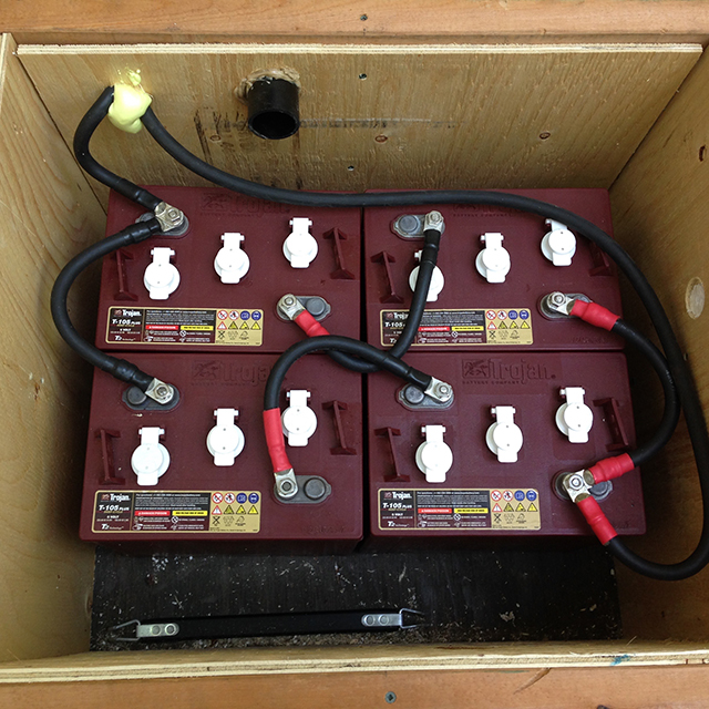

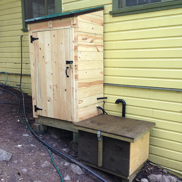

  I chose to locate my solar components and batteries outside my cabin as I need all the space that i can get inside. I insulated and vented my battery box. works great.  Component shed and battery box
  |   battery box

  Clippers got a nice box there.
  As mentioned: among the poor performance characteristics of lead acid batteries: the off gassing issue. The batteries must be in a vented box. The fumes can damage wiring, electrical equipment etc. You do not want the fumes in your home. Period.
