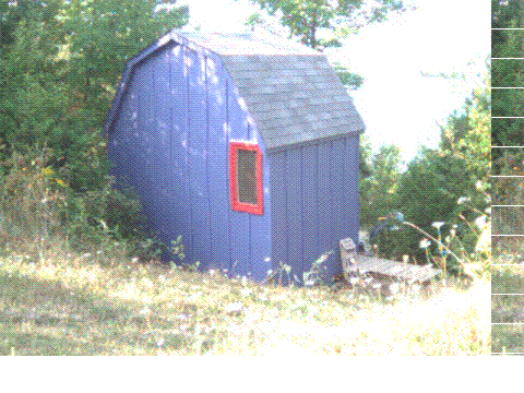

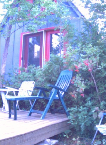

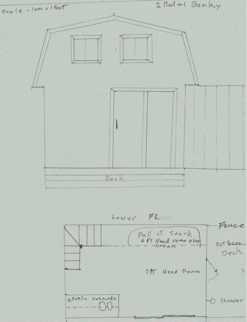

built this one in ontario a few back 8 ft 6 in by 12ft 6 in = 108 sq ft
2 bedrooms in loft with 6ft head room to change, sleeps 4 .
pullout down stairs sleeps 2 , 60 in Ikea kitchen,+ pull down dining table .. 13 ft high
back
back
front
front
only plan i had
only plan i had

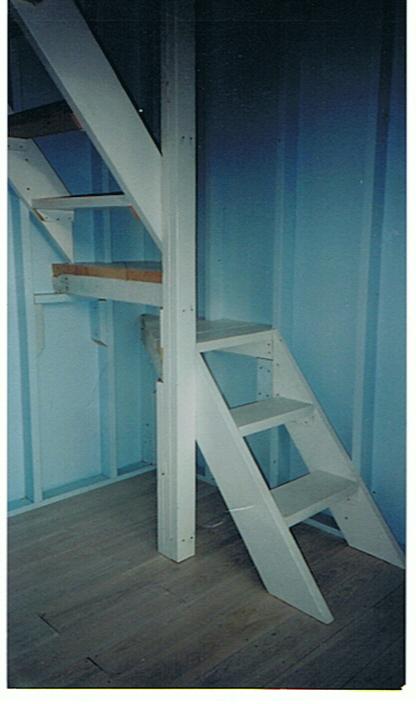

stair
stair

I would definitely go with a gambrel. More work, more materials but more room upstars.

old ugly
# Posted: 2 Apr 2016 08:08pm
we were thinking the barn type roof will give us the most room upstairs. I like the little stairs too , better than a ladder.
