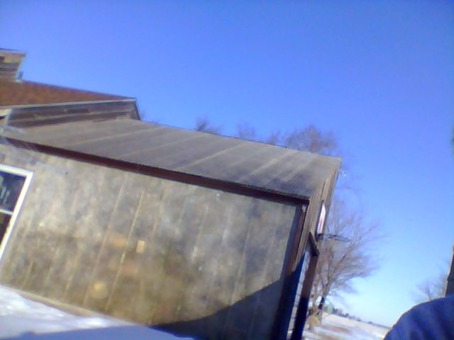

# Posted: 12 Jan 2020 11:50am
I disagree with the recommendations on fiberglass. The resin will off gas and eventually the glass fibers will become exposed. They will trap dirt and dust and end up looking like Just's photo.
Polycarbonate panels, while more brittle, will stay clear and be much easier to clean. I have a fair bit of roof, both here in town and out at the cabin, that is polycarbonate.
Hail isn't a big concern here but snow load is. As long as it is properly supported the panels will handle a large snow load.

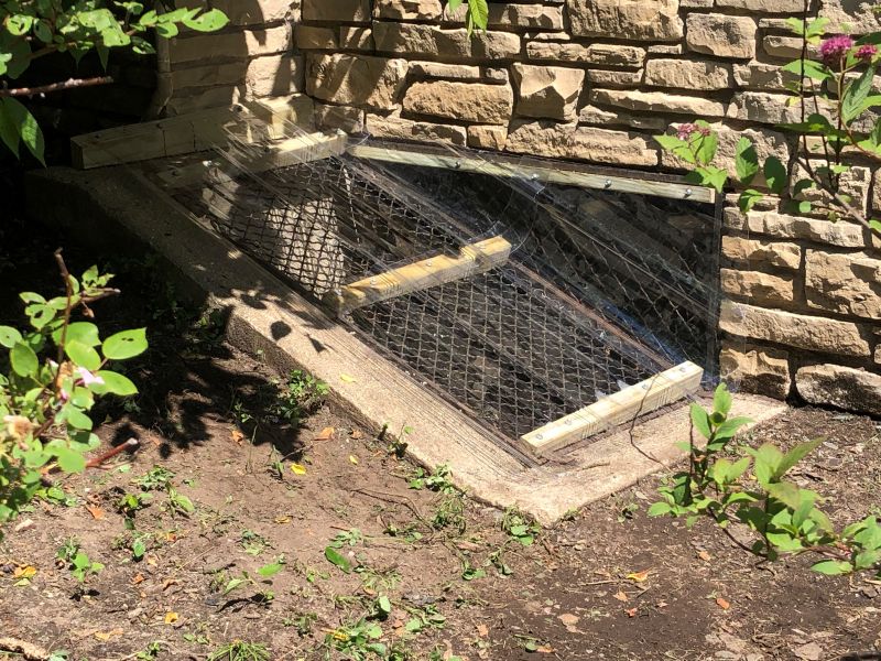

I don't know if this will help in your decision, but I used poly-carbonate roof panel form Menards called AmeriLux that came in a 8' long piece and was 26" wide. It was intended for roofing. I used it as home-made window well covers. Attached is a picture of how it was used on one of my more complicated window wells. I was able to bend it and shape it without heat and formed a kind of flashing with it in one situation. I pre-drilled where it was fastened, but later discovered the roofing screws (with washer under the head) could be driven through without pilot holes. It was easy to cut with tin snips and a table saw, when needed. It's not pretty, but sure did solve a problem with too much rain water from filling the well area and leaking in through the window.

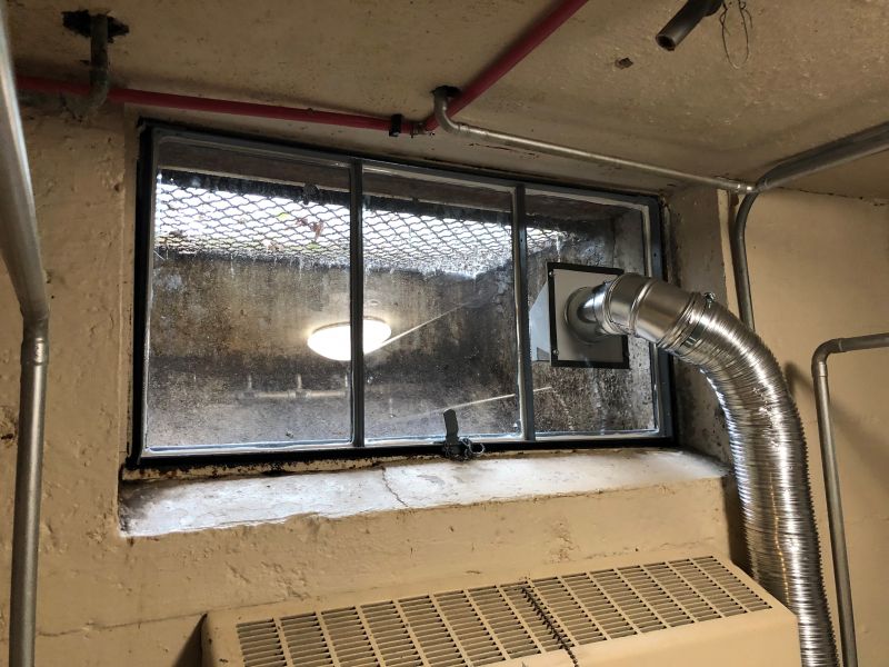

The second picture is poly-carbonate sheet stock, 3/16 inch thick which I cut with a table saw to fit all three areas of this basement window. In addition, I drilled a hole through it for the dryer vent, as you can see. Our house is made of stone, so this was the best option or else a core drilling company would have had to drill through the stone. Anyway, the panels were held in place with silicone caulking, instead of glazing. It worked out well and there have not been any problems for a year with either application.
I hope this helps in showing how the materials can be utilized.
