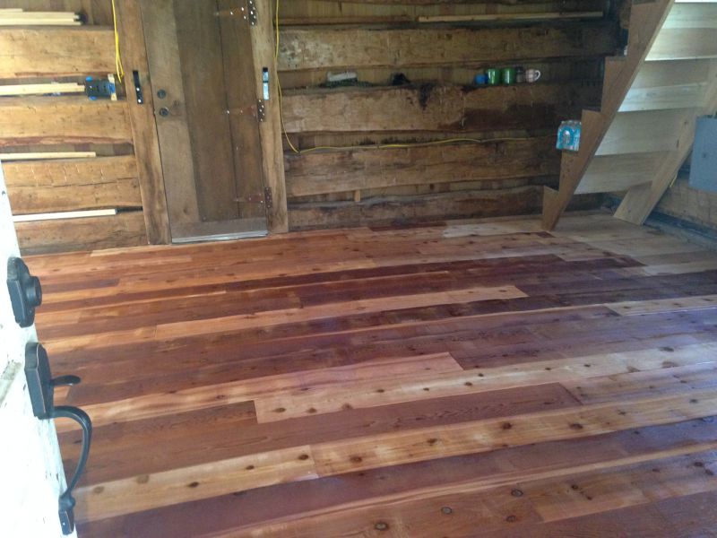

Repurposed fence slats...cedar.
Ditchmonkey
# Posted: 11 Apr 2016 07:54pm
Looks good. How were they finished?

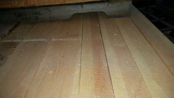

Wow, neat! Someone near where I'll be is selling the 6-inch wide, 5-foot tall Douglas Fir fence slats for $2 each. Flooring would be a good use! How did you fasten and finish them?
Julie2Oregon
# Posted: 11 Apr 2016 08:36pm - Edited by: Julie2Oregon
This is the Douglas Fir. How do you go about reappropriating fence slats for flooring like you did, if you don't mind my asking? Yours turned out super-well! This stuff I posted is 7/8 inch thick. Was yours about that?
Smawgunner
# Posted: 11 Apr 2016 08:53pm
Thanks guys. A friend of mine had the wood...he got 3 van loads from a warehouse that was tearing down the fence. It's heavy duty, 7.5 inches wide by 2 inches thick. He ran each one through a band saw to make two planks out of each slat. The subfloor is OSB board so I liquid nailed it down and shot finishing nails into it. I'd like to go back and drive cut nails in for looks. It's finished with Polyacrylic. I think it came out great! It has that old feel to it...it's wavy from the band saw so it's uneven in places. I took a palm sander to smooth out the transitions.
# Posted: 11 Apr 2016 09:08pm
Cut nails may rust and stain the wood in a unheated cabin, mine did...

Julie2Oregon
# Posted: 11 Apr 2016 09:23pm
That's amazing that liquid nails and some finishing nails would do it! Yay! Thanks!
Smawgunner
# Posted: 11 Apr 2016 09:34pm
Julie, I am a bit worried about it coming up but I used heavy gauge nails. Time will tell though. I'll keep you posted!
